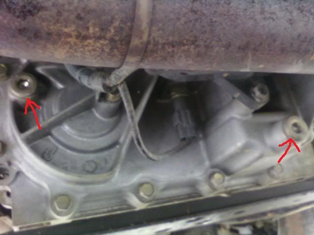

Just traded my dodge 1500 4.7l 2wd for a 4x4 Titan SE and I'm extremely happy with it so far. It has 215,000 mostly highway miles and drives perfect. On the downside, the transmission fluid is pretty burnt and I'm sure the transfer case isn't much better. I will be changing the transmission fluid tomarrow if everything goes right and the transfer case fluid today. What I need to know is where are the plugs on the transfer case. In the picture below, is the fill hole the left bolt and the drain hole the right bolt?

Your on the right track. Throw some Mobil 1 synthetic ATF in there and you'll be good to go. You can also use amsoil, Redline, or even the genuine Nissan stuff if you like. Just make sure you go with something synthetic.
