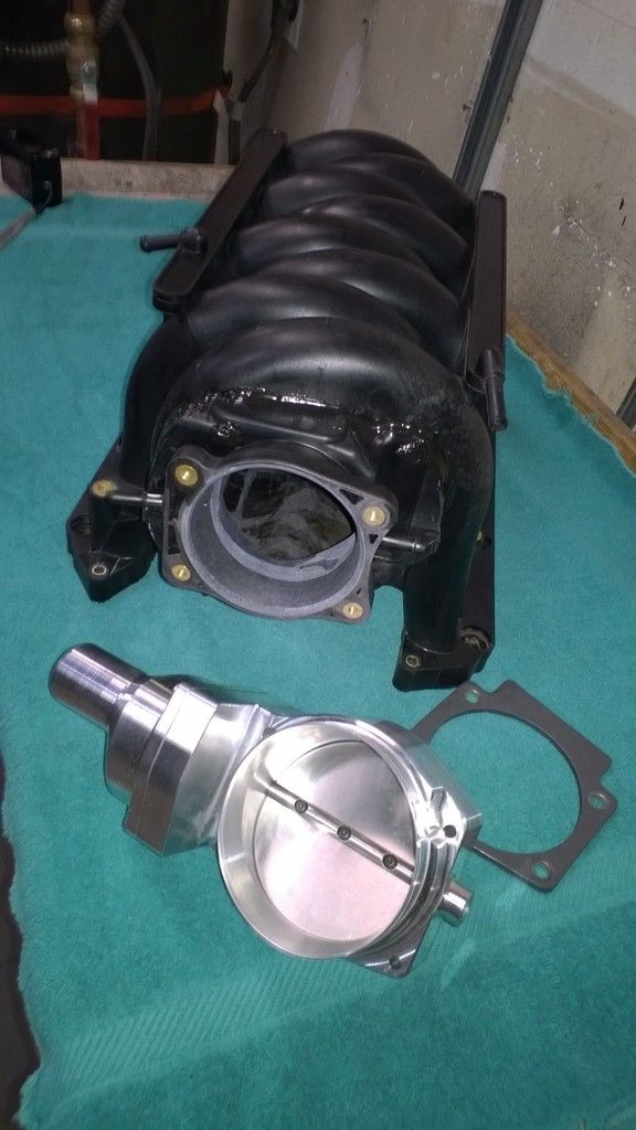

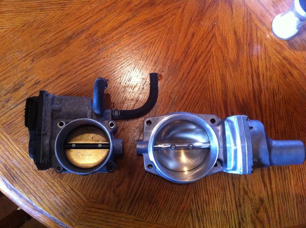

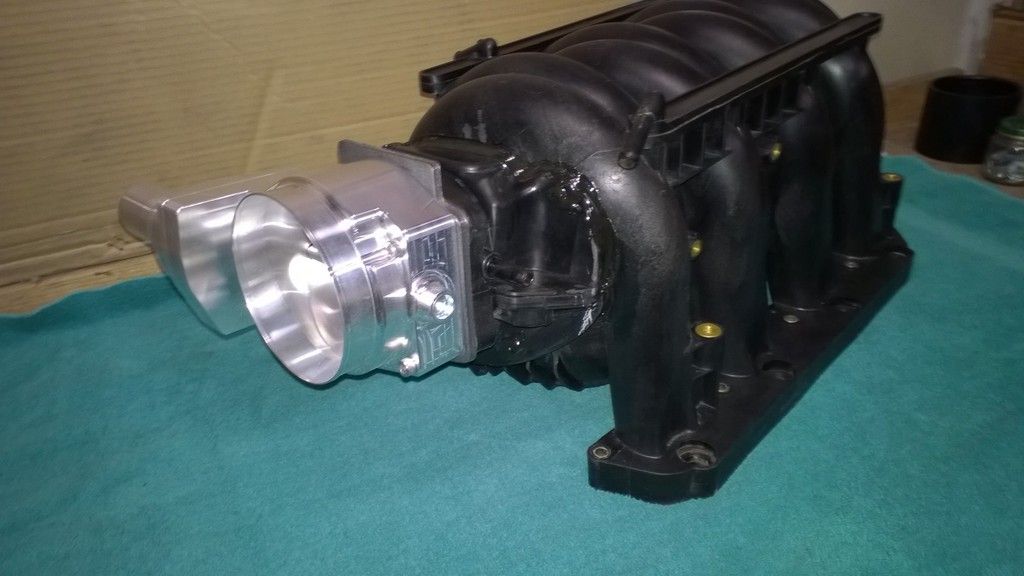

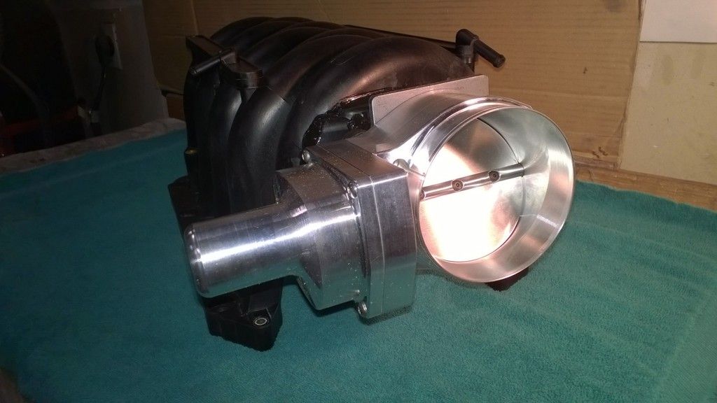

Venom 102 created by myself and Randy Baker along with Bob at Peak speed shop.
I loved the performance i got from the MGT90 but hated the issues. So i decided to work off the idea of the MGT90 and make it better. For performance and drive ability.
I had bob graft the same LS neck onto the OEM intake and perform his very own porting process to port a LS 90 to 102 for the GM people. This allows us to bolt on a Nick Williams or any Fly by wire 102mm Throttle Body made for a GM application. The same wiring harness is used from the MGT90 so no worries there. New gasket from Peak Speed shop is required.
Cool factor is for the people who already purchased a MGT90 they can upgrade at peak speed for a fraction of the cost since the LS graft is already performed! Just purchase the Nick Williams TB and gasket from Peak Speed , Have bob port your existing neck graft and install! Randy Baker has exclusive tuning for this setup and make the transition very smooth.
NO MORE COLD START ISSUES!!! This was the main focus as well as more HP and TQ over the MGT90 . This intake has removed all the hard starting and extended warm up times. For myself and Jon Long. It flat out works as good as OEM! Just took a 1800 mile trip from northern NY to VA and averaged 20 MPG !!!! No Joke! Tuning is essential for this!
Gains over the MGT90 are good! Not huge but what we expected! Data logs show more air being flowed and track times and 0-60 logs show the same!! Its the Future for a serious Nissan Mod crazy person.
