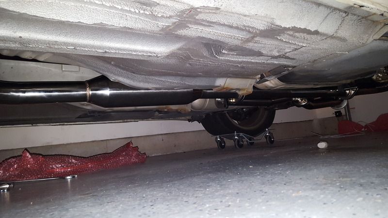

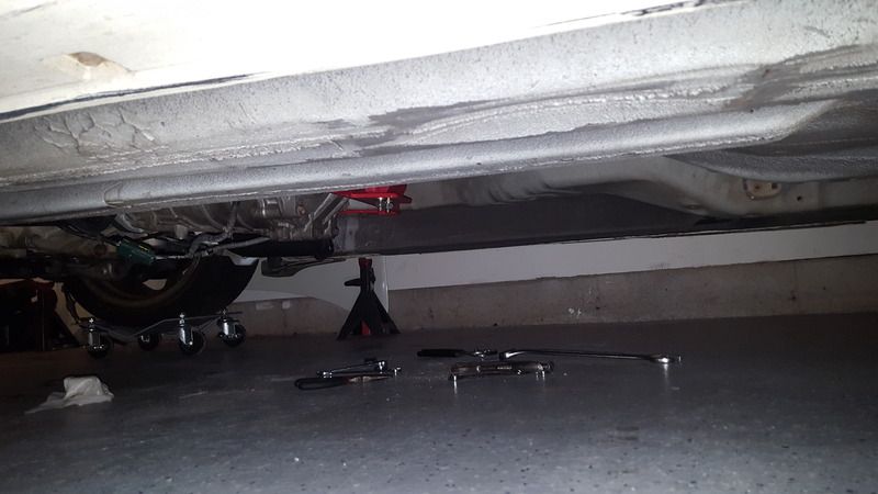

ok so slow update and not great pictures yet cause I was pissed off that I was missing a gasket and short hardware, but here are the crap pixs far, and my amazing driveshaft as EYE candy.
Exhaust so far
Exhaust so far
