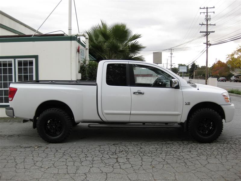

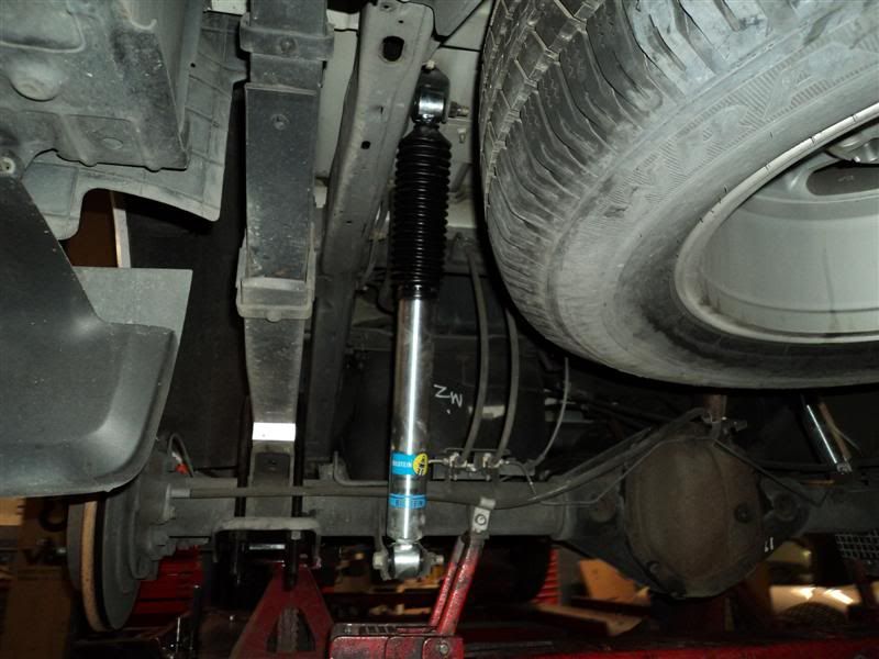

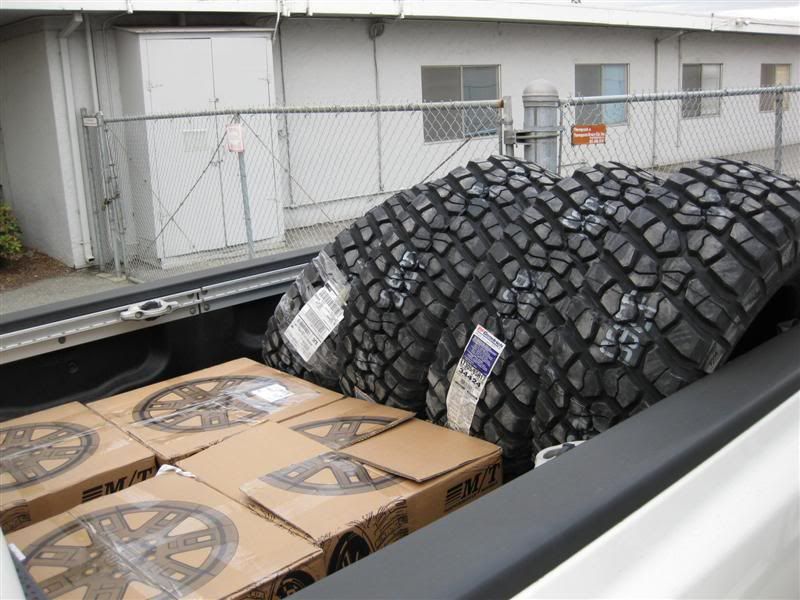

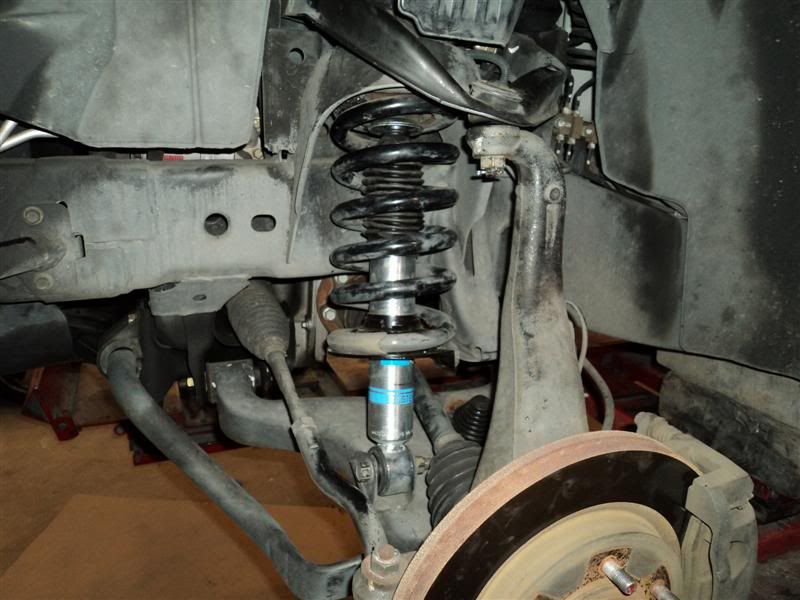

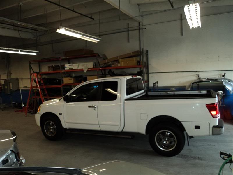

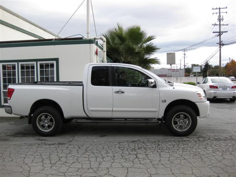

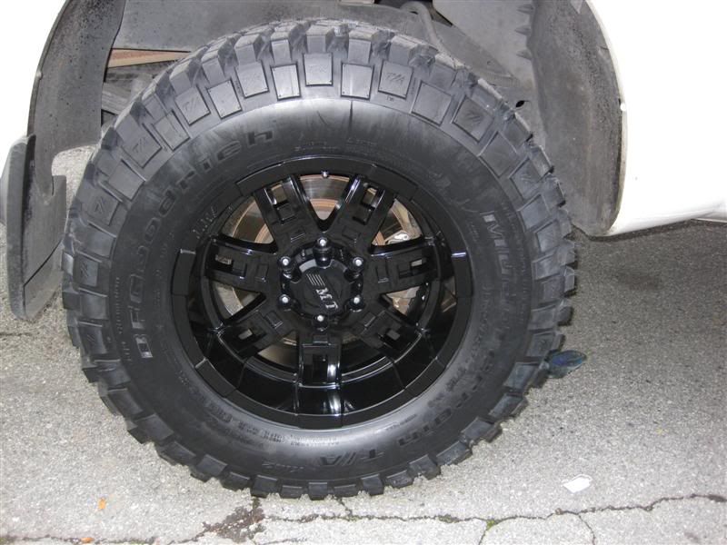

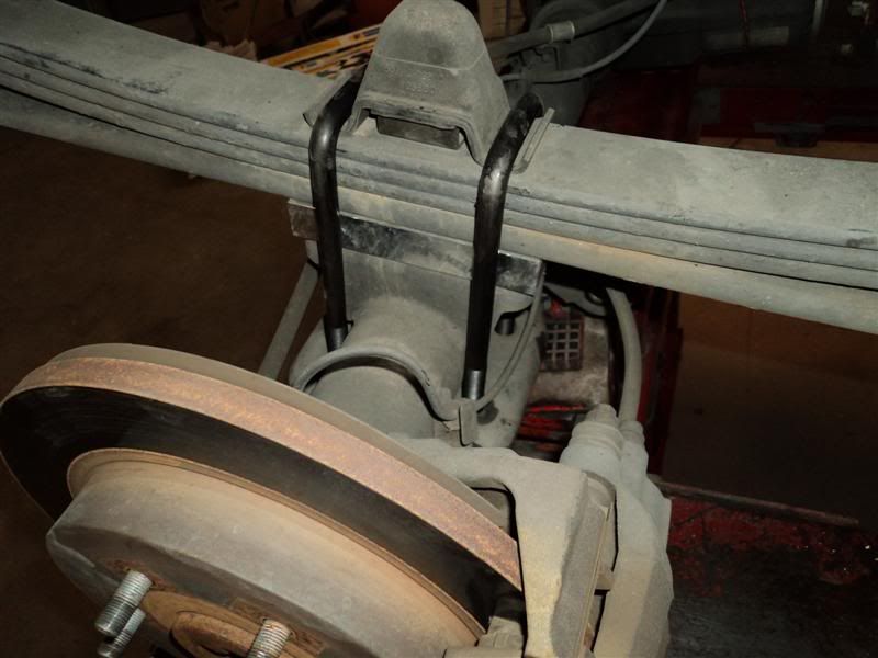

Just thought I would post some pics of stuff I did to my Titan this weekend. Im a very happy man right now, was definitely looking forward to driving to work this morning. I installed a PRG mini lift (2" front & 1" rear), installed Bilstein 5100's (Front set a o) and rear shocks. Got the tire shop to mount my Mickey Thompson Sidebiters 17x9 wheels and BFG MT KM2 305/65/R17 tires on Saturday afternoon. The photos dont really show it but the lift and tire combo makes the truck alot higher than stock, definitely glad I didnt go with a 6" lift. Truck rides better than stock and looks better than I imagined it would. FYI, I havent experienced any CB contact as of yet and I tried to make it happen. Tires make noise but probably just need to be driven a bit, black rims on white truck look frickin awesome. Any questions just ask, have more install photos if needed.
RIM & TIRE
REAR SHOCK INSTALLED
REAR BLOCK INSTALLED

FRONT STRUT INSTALLED

AFTER LIFT AND 5100 INSTALL
WAY I BOUGHT IT

Looks great man. sounds like a good weekend. IMO if you put the bilsteins on the second notch it'd look good too. but you prolly will get coil bucket contact at times. and i also like the front end higher up, so i'm biased.

Thanks. Im on the flip side of that, I like a little rake. The photo makes it look like it has more rake than it does, maybe the ground wasnt completely even. On level ground it has a very slight rake.

I originally ordered the HDs, still have them sitting in the back of the shop (thanks for the reminder to return them). After a lot of searching and reading, I decided to go with the 5100s because I wanted that extra 1/2" up front for leveling purposes (would have an extreme rake without it) and the option to go higher later if needed. I have not had any CB contact while driving so far and have tried to make it happen by driving over speed bumps and dips. I dont off-road so wont have to worry about any contact while wheeling. I would still like to get the a/m UCAs at some point, but at over $500 they can wait. I did notice however that when I jack the vehicle up by the cross member and the control arms hang down they do appear to make contact with the coil bucket. Probably could be fixed by shaving the inside edge of the UCA or outer edge of the CB. I will let you know if I experience any issues with CB contact later on, but I may be one of those lucky ones who just had enough space between the UCA and CB to not have an issue.
