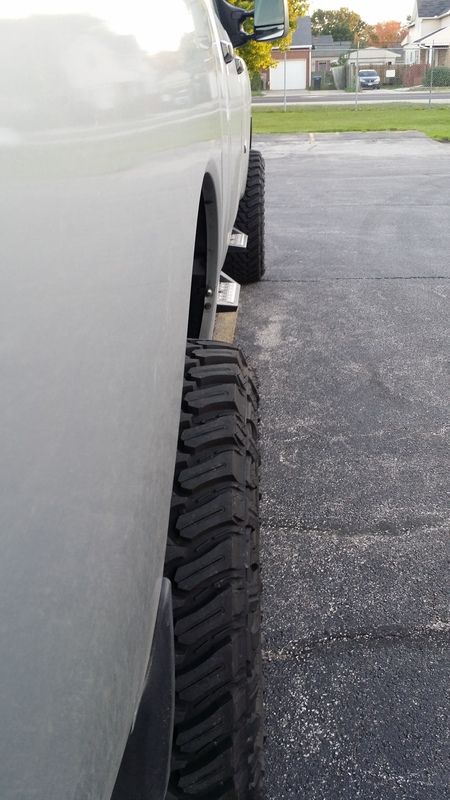

Yes! i think those were my 3rd choice of wheels! here's mine Fuel Hostage 20x10-24mm on 35's no spacers sitting on 8-9" of lift

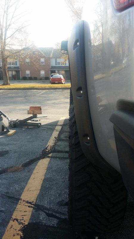

and here's just for future reference as i didn't plan ahead about adding fender flares to the truck. if i would have known i would have went 20x12-44 and eliminate the need for current 2" spacers. here you can see my tires are sitting inside the fender flares ::crying::
adding 2" hub centric spacers
after:
and here she is sitting today!
