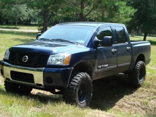

ATPto the right of the 4L came on when doing the below over lunch. whats it mean? oh yeah, it came with a nice annoying beeeeeeeeeeeeeeeeeeeeeeeeeeeeeeeeeeeeeeeeeeeeeeeeeeeeeeeeeeeep!
