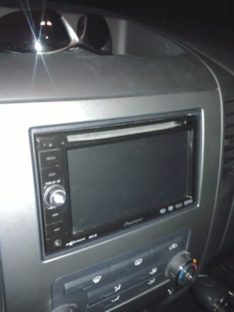

Since I already had the Pioneer AVIC-D3 installed in my SE dash, I figured the Xterra trim would hide the gap perfect and it did!! :redblob"

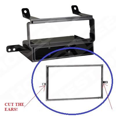

I then just purchased the cheap $16 dollar Metra 2nd gen (2005+) Nissan Xterra dash kit and used the double din little trim piece only.
The kit comes with a single din and cubby hole piece as well, just toss that since its not needed.
I used this piece circled, and cut off the two ears shown:
Finished product with Xterra trim piece:
Aside from the Xterra kit, im sure others may work, but the Xterra kit works great.
I will update later, i did have to mount the AVIC-d3 on the top holes, thus dropping the D3 down a few millimieters to make it center in my SE dash.
I used NO spacers when mounting the D3 to the dash, all my rear wires fit no problem..

For reference here is a pic in our Xterra with the same Metra kit ring:
The Metra P/N kit i used was 99-7581:
Sorry for the blurry pic - but as you can see, the kit comes with single and double din pieces.........all you need is "item D" shown circled.

Took another pic.......this is just showing the little trim ring sitting on the factory SE face...
