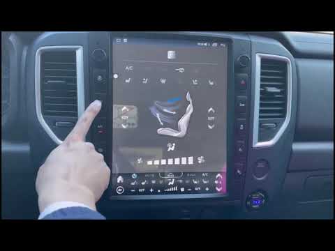

Has anyone tried this?
It lacks SiriusXM but it has CarPlay or can simply install from the Google's App Store. I'm about to get it but I'm waiting for an answer on what features from the dashboard may be retained.
