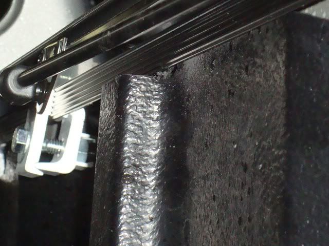

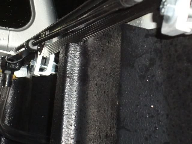

Ok, i was told that the bakflip would fit no problem with the factory bedliner. I got the G2 bakflip and found that the factory bedliner does hit the rails and needed to be cut.
I had to dremel off about 1 inch off the tips that lip over and catch the bed lip.
Here you can see the cut bedliner tips:

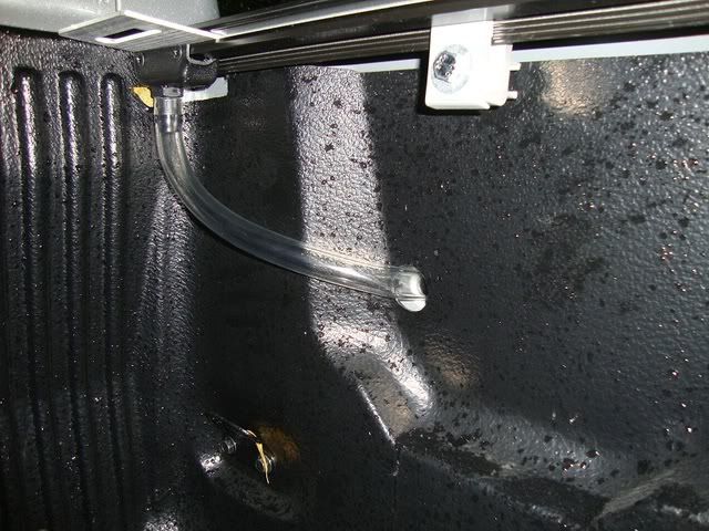

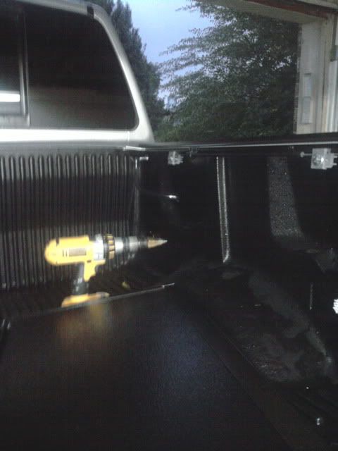

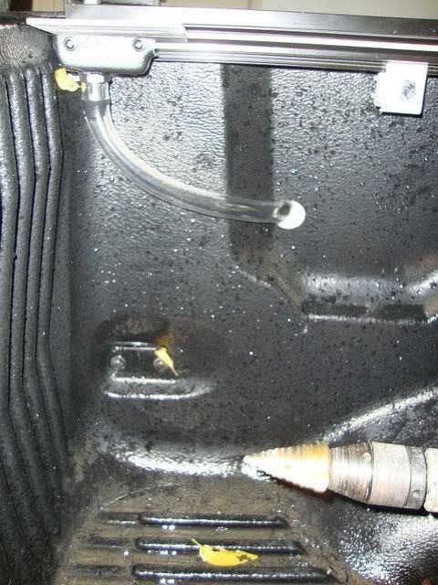

I also thought i would provide the dimensions of where exactly to drill into the bed liner to route the drain tubes: Measurement from first bolt (closest to cab)
I guessed based off of other pics posted I saw and luckily got so close that I was able to pull the step drill bit to nearly exactly center...:eyebrow:
I just continued drilling into the metal existing hole opening it up just enough.
I used a step drill bit from harbor freight and drilled out the existing hole in the bed to 7/8" and that let the tubes fit snug - had to semi force the tube through, which was good, cause it held the tube in place and didn't flex back out.....
You can see the step drill bit I used here:
Drain hose routed:
Done:

It looks like your clamps are angled outward. If they are, that is causing your bakflip rails to lift up. You will need to adjust them some so it makes a flush tight fit. Mine originally the tailgate would close when I first installed it with the bakflip closed. But after they sent me the modified clamps, it can't close now unless the bakflip is raised up.
Looks good though!

Nice write up!! Don't want to hi-jack your thread but for those who have Utilitracs you have to flip them upside down if you still want to use them. The rails are slightly long (designed for no-utilitracs).

yes, the rails do hang down a bit more than what you would think is needed.....my guess is that backflip uses that same rail extrusion on many different backflip models on other trucks........trucks with bigger lip hangover or what not.....
the titan lip is small and you kinda gotta look up back there to ensure you are clamping a good amount of area when tightening everything up..

Cool, Jason.. In that case... While on the topic.. Hope this helps... The only drilling needed is to enlarge your draintube holes.
With the rails flipped:
Enlarge Draintube holes:

Here is my drain tubes. I bought skinnier ones with a adapter and it works great. No need to make the hole bigger and worry about rust. This picture was before my modified clamps. You can see the angle there.

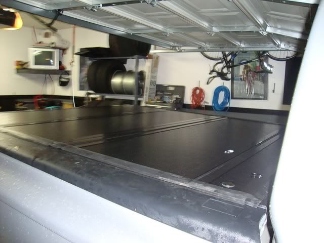

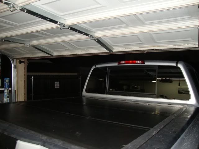

This cover looks great! Thanks for sharing the information. Can any of you guys with the cover post some overall photos of the cover installed? Do any of you think the HD cover is worth the extra cost?

^ The existing hole in the truck is only slightly smaller than the hosing that is sent with the backflip...either just simply measure the hole yourself or just run over to homedepot/lowes and hand carry that section of hose that bakflip sends with their unit with you and get the next size smaller.....while your there, buy an adapter to mate the two....its probably a 5/8 ID hose with thin wall tubing, or 1/2" with thick wall tubing...
as for rust, i mean, c-mon, your talking about cutting an existing hole only slightly larger....the only exposed unfinished metal will be the thickness of the cut edge.....you could shove the hose in there and add some sealant if you want...or get a little hobbiest brush and paint on some primer.......were not talking a large area here guys....abet, also covered by the bakflip so not directly hit by rain either...
though i think its cool you can do the adapter and next size smaller tube...the set up i have i feel looks much cleaner...
