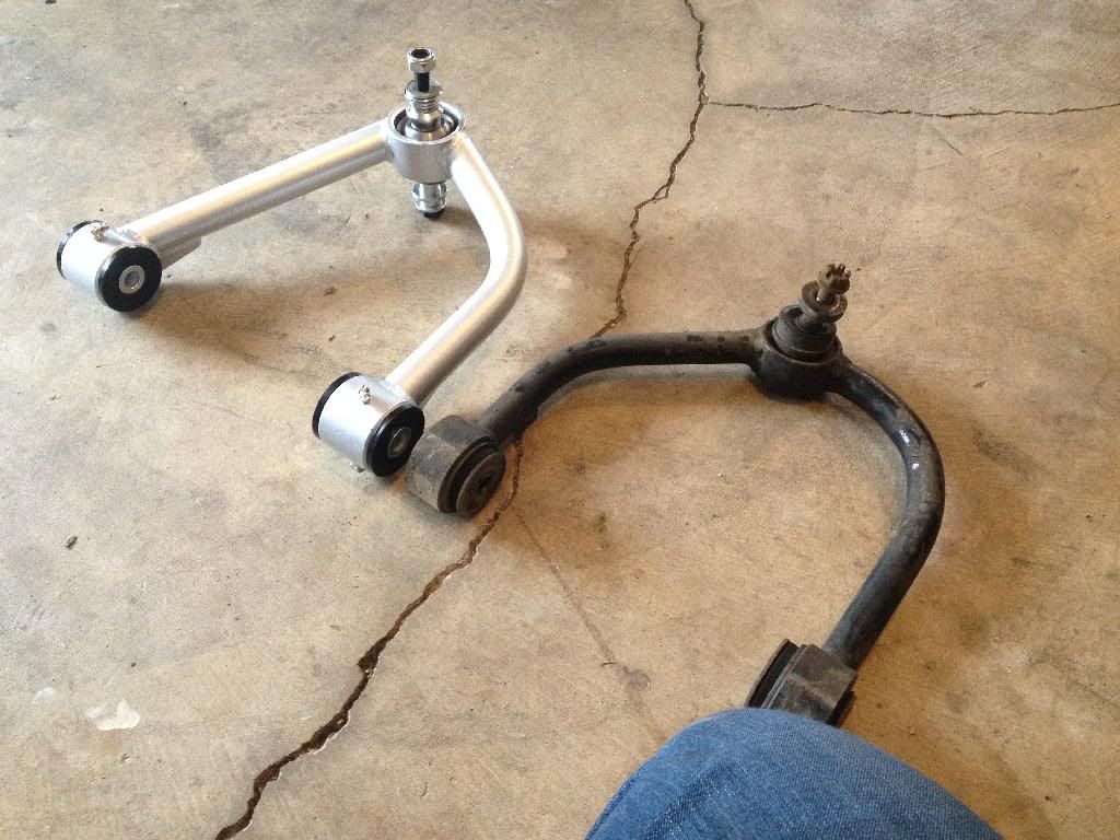

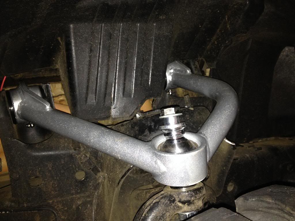

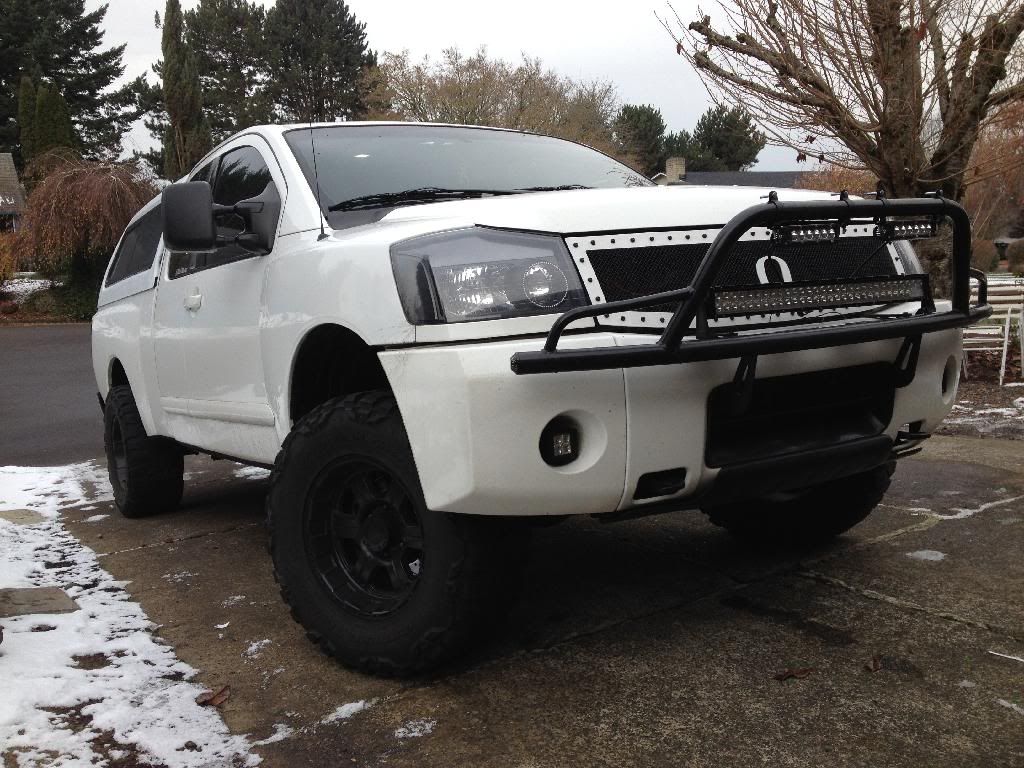

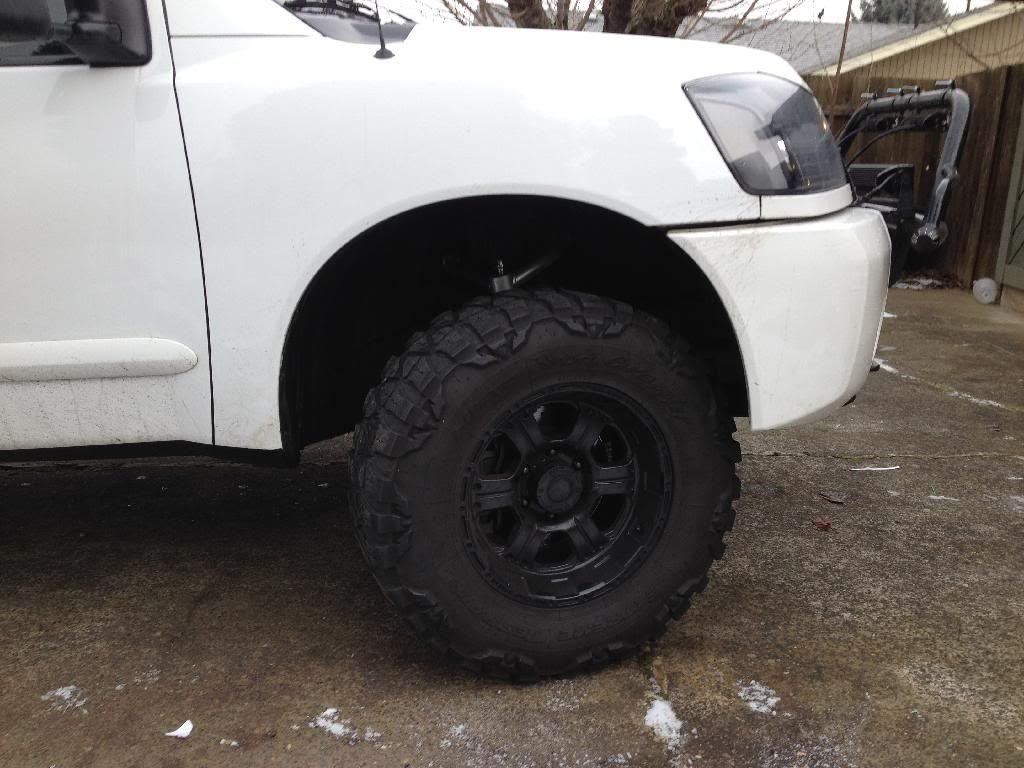

These new Total Chaos clones are AWESOME! I switched from the Rough Country to the TCs this morning. Definitely worth the switch. Before with the RCs, it would rest on the CB before the tires left the ground. With the TCs, it touches just after the wheels leave the ground. Measured the gap between the top of the tire and the highest point of the fender. The RCs measured 9.5". The TC clones got a hair over 10.5". A full inch of additional downtravel!
RCs before full droop...
TCs at full droop, just touching.

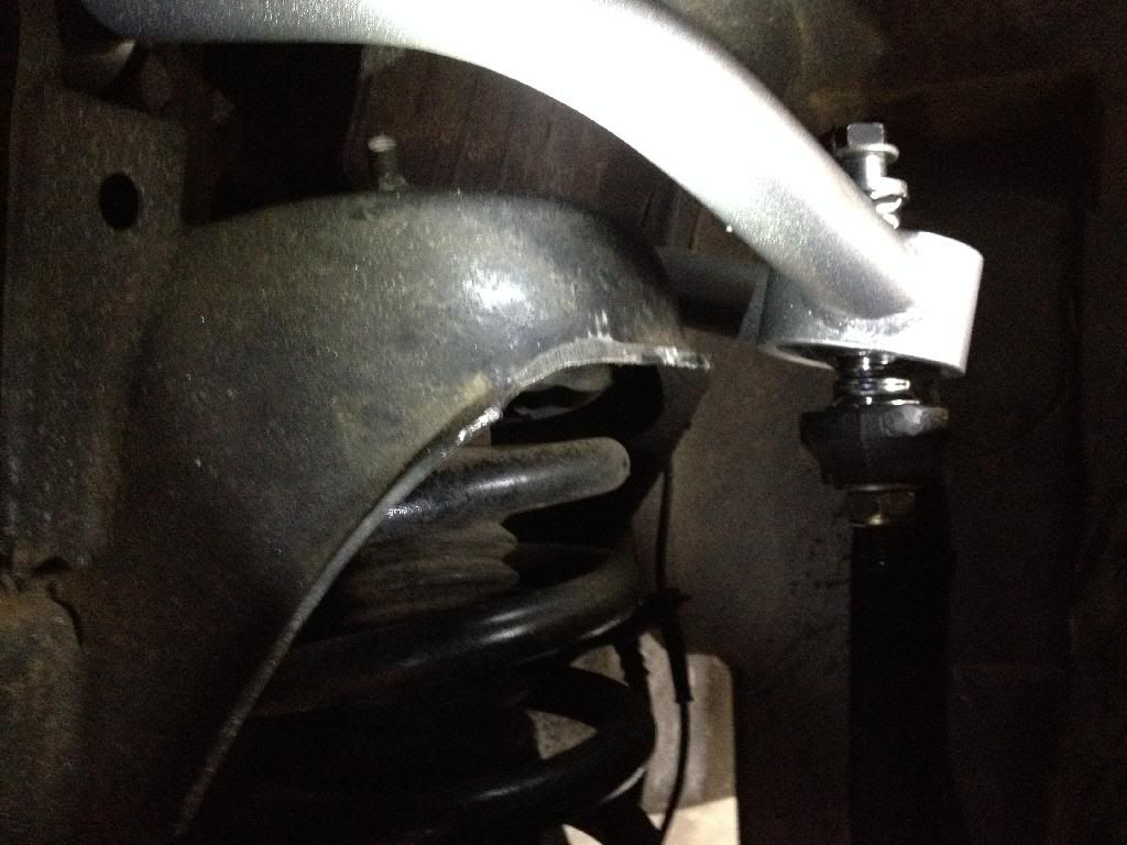

I did have to do the Total Chaos modification, otherwise it was a really tight fit.

Did you trip the coil bucket just because? or did they hit the bucket before you trimmed it?
They look really clean and well put together!
#11 ·
If you never had them trimmed do you think they would have made contact?

Yeah. Not a ton, but some. I do have 3" of lift up front... I wanted the most travel.
