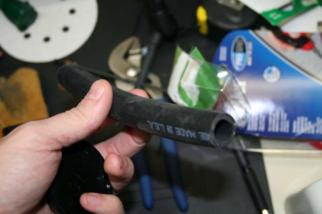

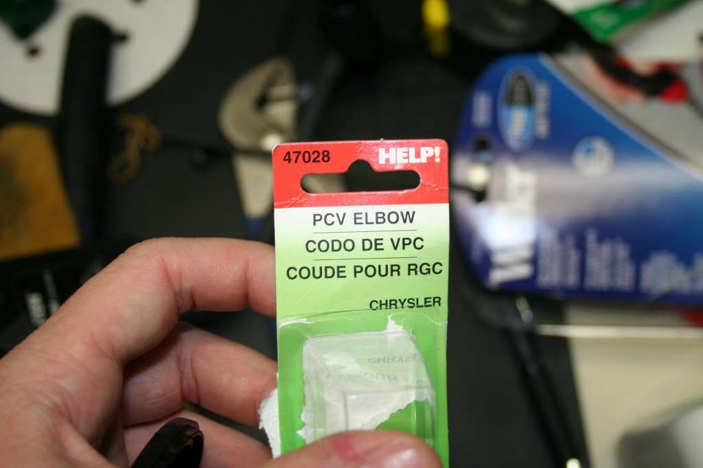

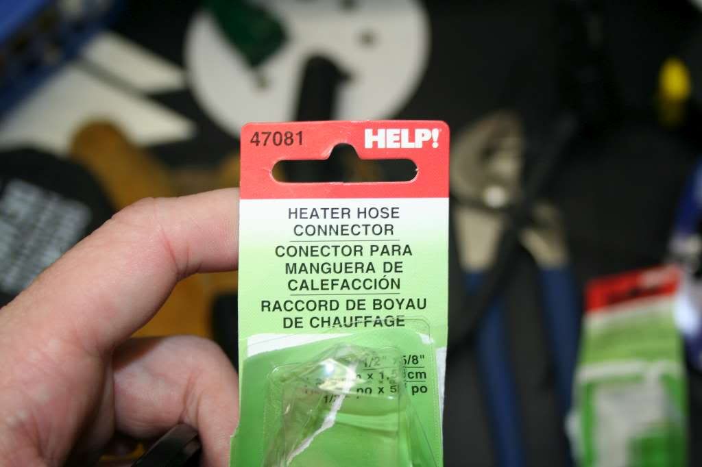

here is what you need.
an elbow, a heater hose connector, and a length of hose. Here are the packages of these so you can see the part numbers.

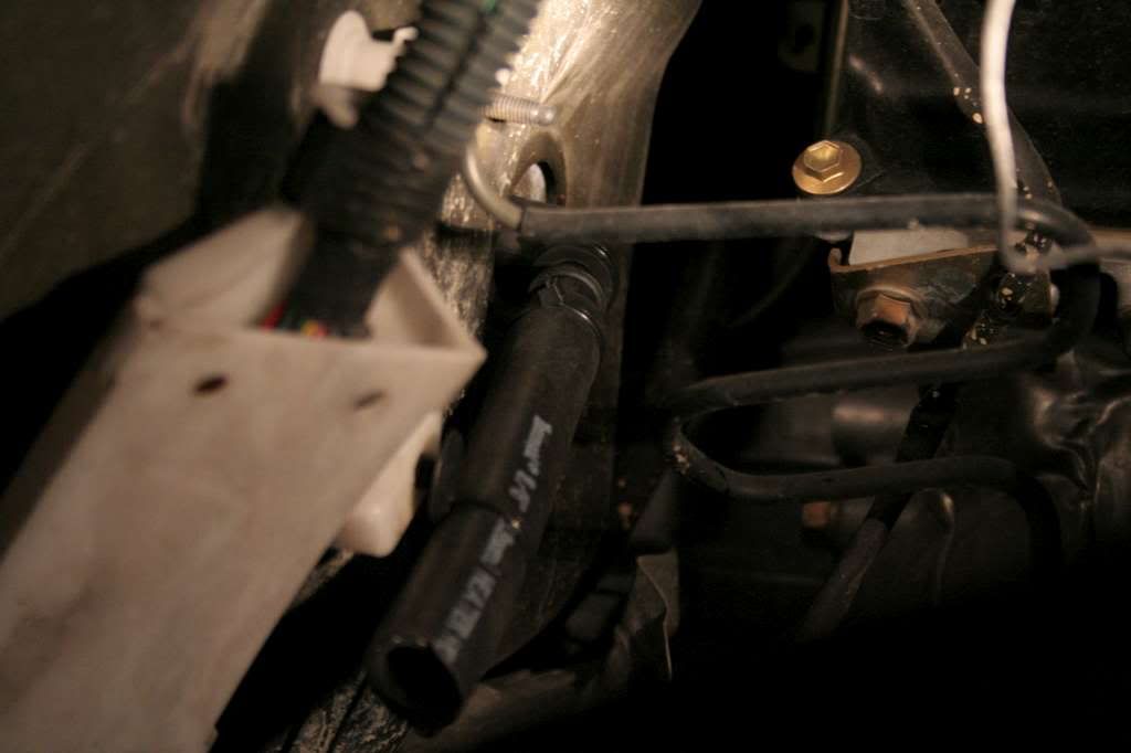

i put these three items together and used a couple of zip ties to hold them together, although the fitment is pretty snug. I then removed the stock diverter, and reused the push in holder off the end of it. i drilled a small hole in the push pin, and ran a zip tie through it to hold the end of the hose assembly. this is what it looks like installed. It was dark and i will get better pics when its daylight.
all together it cost about 7 or 8 bux for the parts, and all of 10 minutes to install. now there is now way it will drip back into the cab!
