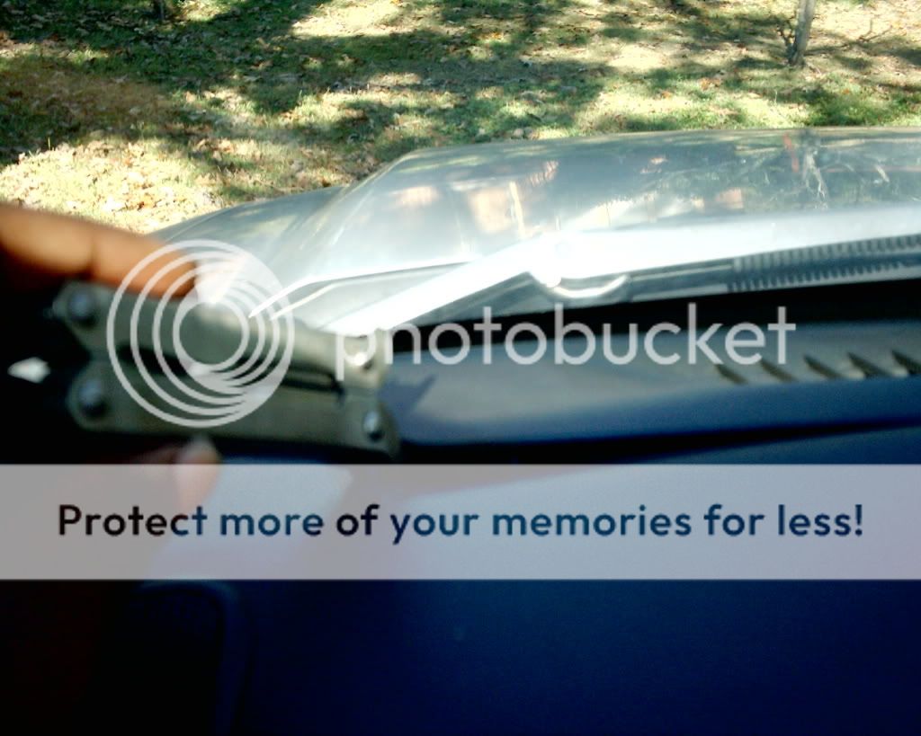

Just thought I would upload some pics on removing the defroster as someone requested them. Its very easy.
Use a screw driver and pry the corner up.
http://i616.photobucket.com/albums/tt243/bizzox-87/titan/removedef/IMAG0003.jpg

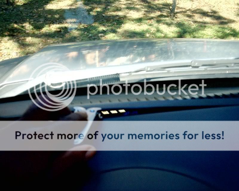

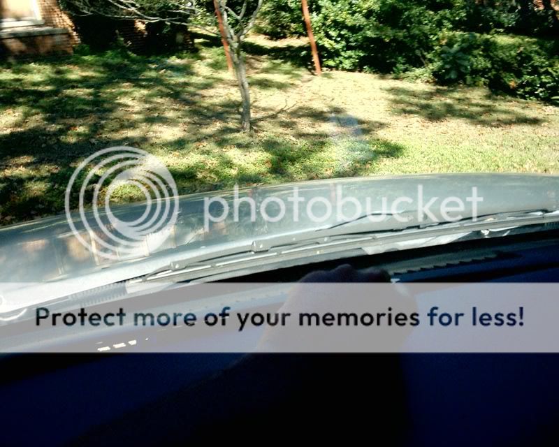

Keep doing this all the way down
http://i616.photobucket.com/albums/tt243/bizzox-87/titan/removedef/IMAG0005.jpg
http://i616.photobucket.com/albums/tt243/bizzox-87/titan/removedef/IMAG0006.jpg

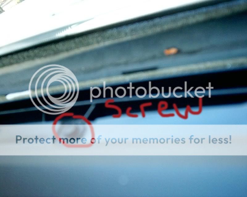

There are six little black screws going straight down and three bigger screws going towards the front. The three bigger screws are 10mm and the smaller black ones are 7mm.
http://i616.photobucket.com/albums/tt243/bizzox-87/titan/removedef/IMAG0007.jpg
http://i616.photobucket.com/albums/tt243/bizzox-87/titan/removedef/IMAG0009.jpg
The only hard part was lining the dash back up so it pops back in.
After doing this my dash don't vibrate anymore. "idhitit2:
