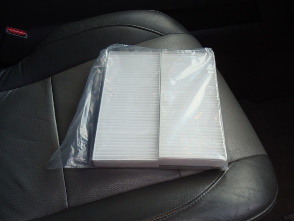

Here are the new ones.

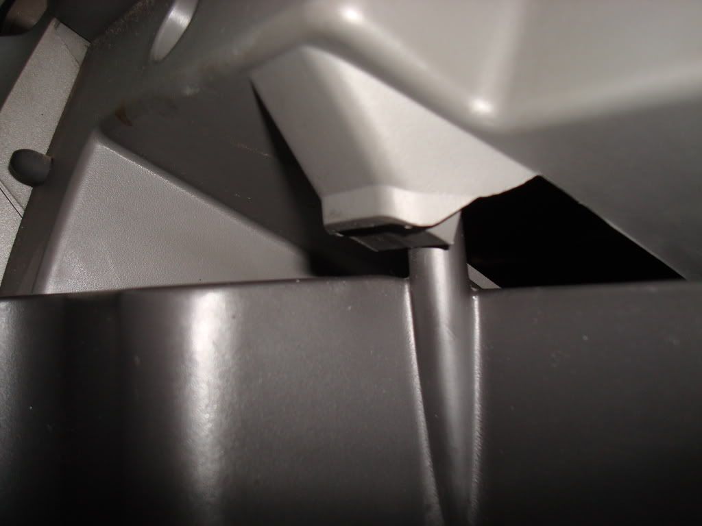

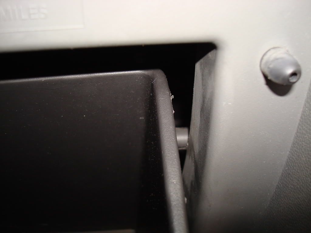

there are two posts that keep the glove box from opening all the way, you can easily flex the box and get it to come out without removing a bunch of bolts.

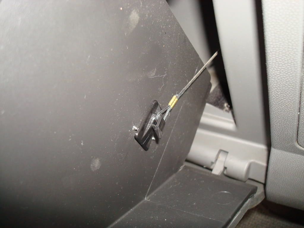

Once the box is open, you have to release the cable that holds it closed. This just slides out of a notch in the side of the box.

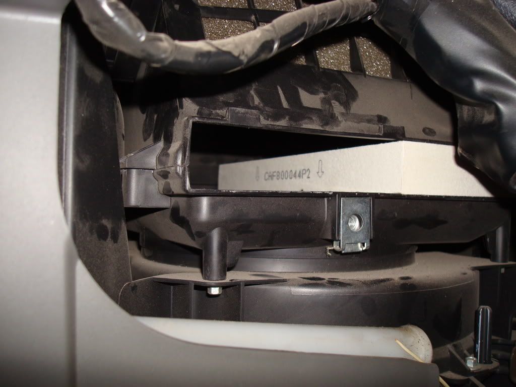

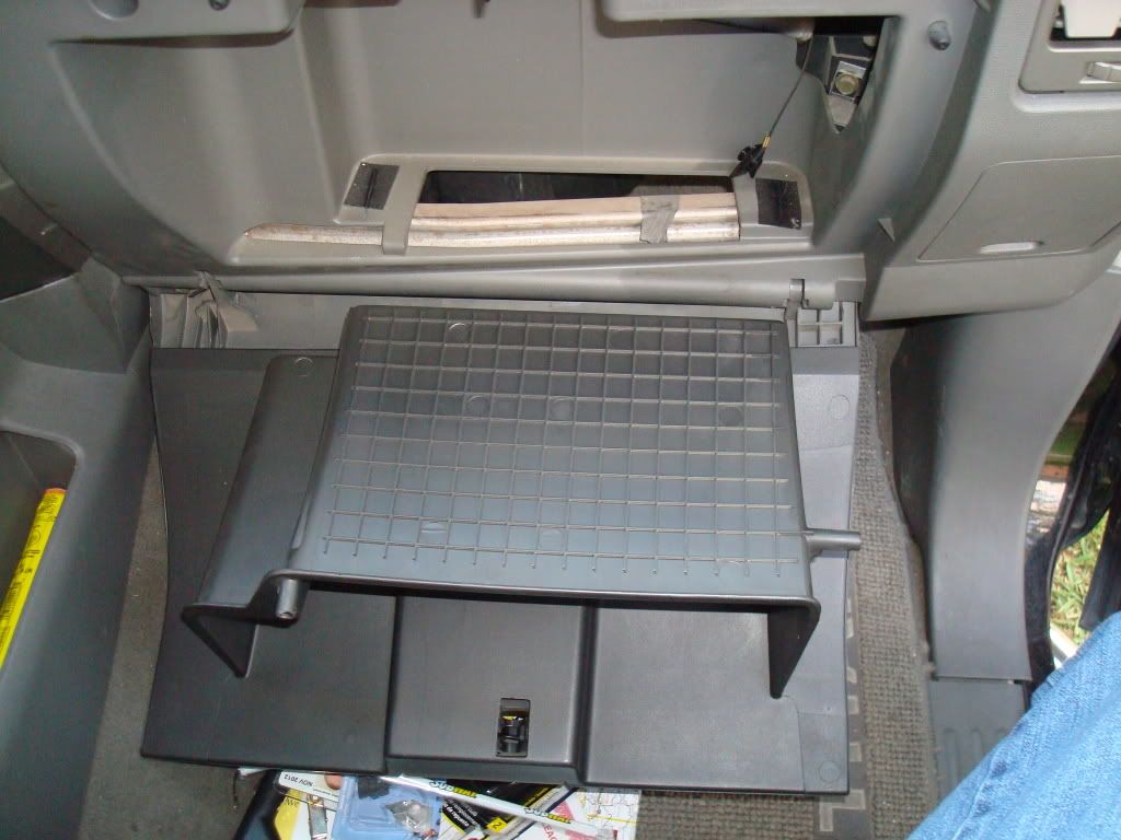

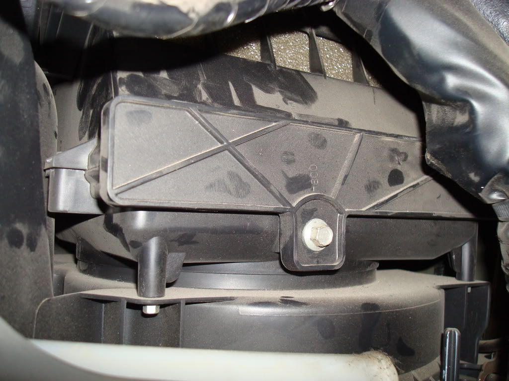

Once the box is down, you can see the lid for the covers, remove this screw.
removed the lid and you can see the filters (or lack thereof)
use a flat blade or knife to removed one, then slide the other over and remove it as well.

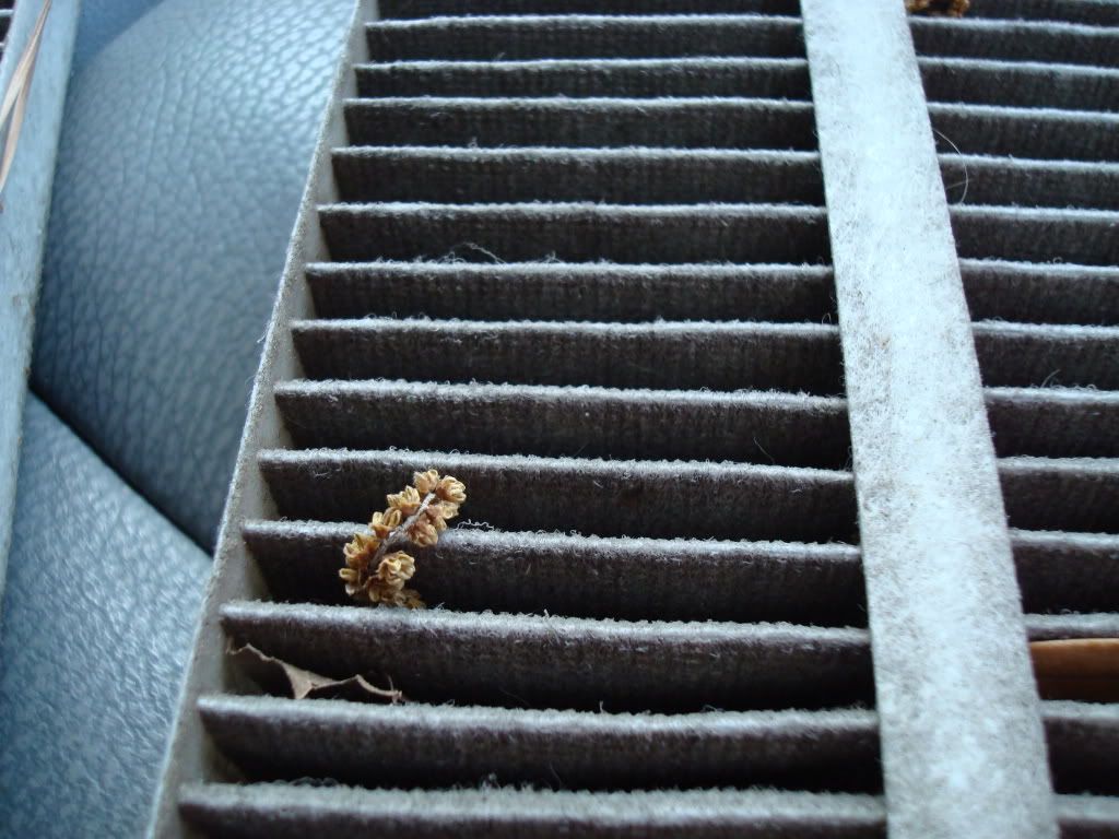

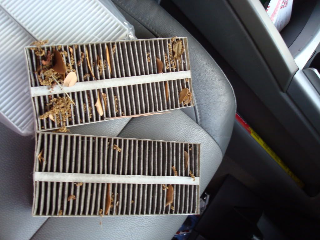

Mine were pretty bad. I ran my air for a minute to make sure no leaves and crap were still in there.

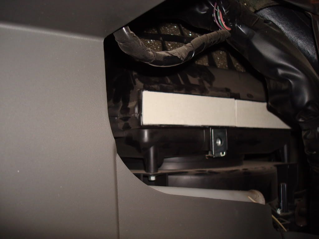

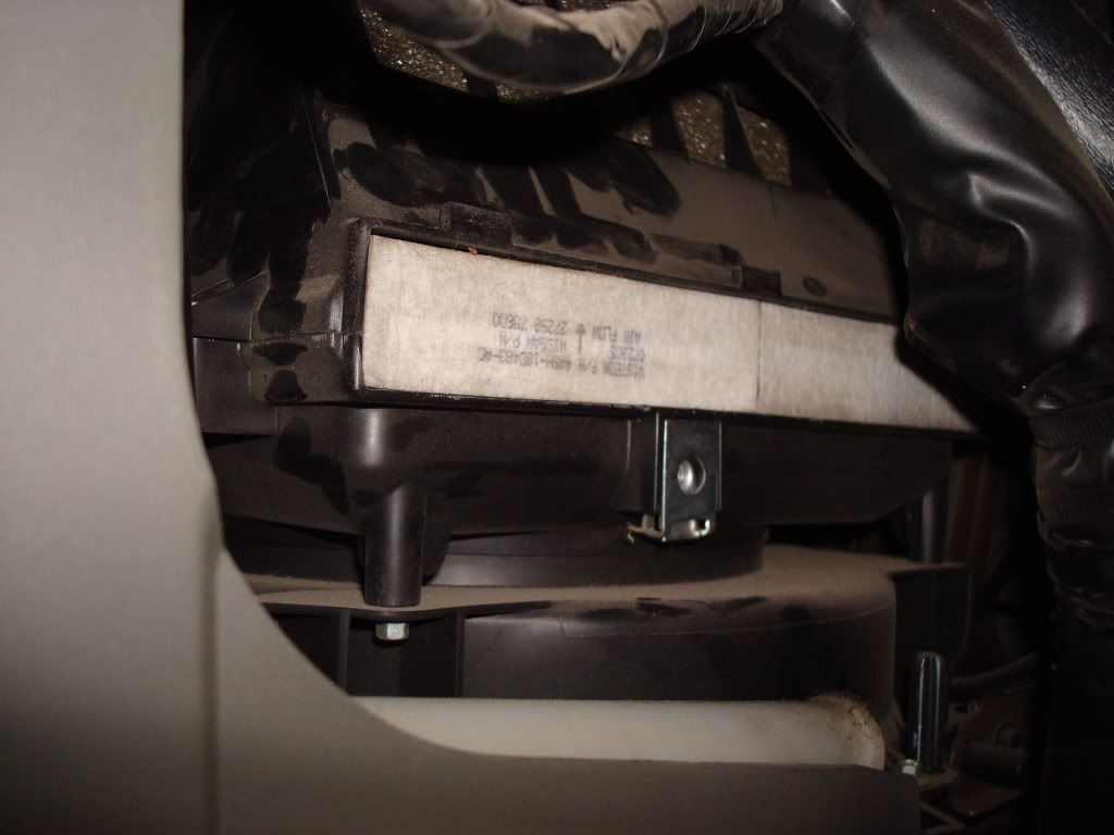

Install is reverse of removal, slide in one, push it over, and slide in the other. Be sure to pay attention to the air flow direction arrows.

Are those the ones that feel like paper right?
I bought 2 sets in 2 weeks (due to mice eating my first one) (one from trustednameautoparts) and the second set i bought from "aircabinman" on ebay. These (aircabinman)had no air flow arrows, but are made of a "plasticy"/styrafoam (hard to explain, but did not feel like paper) material that i liked better than the paper feeling ones. Who knows if they filter better or not though, but for $11, they are also a good deal.

I haven't seen this mentioned yet so I'll throw it in; you can just clean and re-use the original factory filters. I washed mine a couple of summers ago and it made a huge difference in the freeze factor.
First I removed any debris like bugs and leaves.
Then, using warm water, I just rinsed them in the sink. I ran the water through the filter from the clean through the dirty side till it was not too dirty anymore. Then sprayed them down good with 409 or similiar and let them let soak for 10 minutes. Them rinsed again till totally clean. I may have used a soft brush to scrub lightly, can't quite remember. Set in the sun or anywhere to dry and when dry re-install. Just like new and $0.00. I was prepared to go get new ones if they fell apart but they seemed pretty sturdy. They have been working great ever since, good cold air whenever I need it and we get 100+ here all the time.

After reading these posts, I am still confused. Arrows up or down. The manual says the arrow should point down, so I installed them with the arrow down pointing toward the floor board. The white strip in the middle is facing up toward the roof. Is this correct?
#40 ·
yes arrow down. the arrow shows air flow direction. the air comes in under the windshield, and flows down into the fan below the filters.
I installed mine correctly. It was the ones i took out, that were in wrong.
