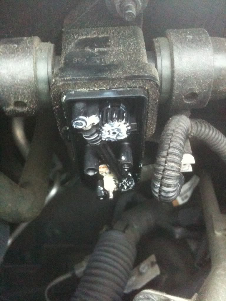

My solution was to take out the cover, cut the top of where the valve gear sits inside the cover (pivot point) just enough to open it up but not ruin the weather seal and make a slit on the plastic gear using a dremel or a hot knife to fit a flat head screwdriver (in order to use it as a handle).

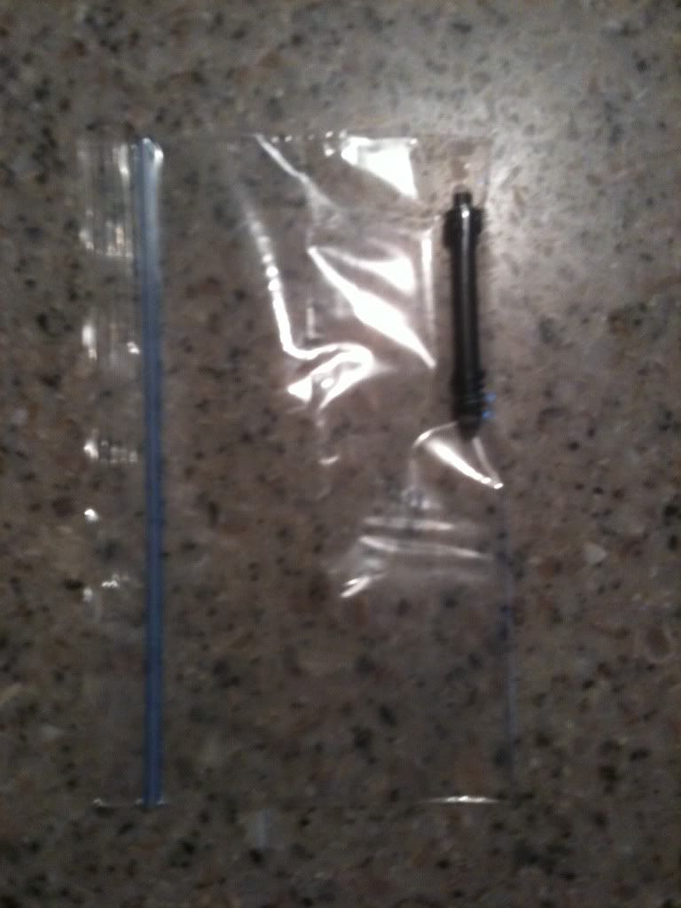

Put everything back together leaving out the useless shaft.
Use a small flat head screwdriver to operate it (quarter turn) ( I _ )
Should take about 10 minutes and works good
PS if you plan to drive your truck underwater it might be a good idea to put some silicon around the pivot point but it doesn't really matter because you are no longer using the electrical part. You might also want to remove and seal the plug to the bottom right of the assembly

Water valve or control valve (whatever you call it) is junk. Made of all plastic.
I found it here. Against the firewall and easy to reach.
Opened it up, turned the heat on and it did nothing. I touched it and the gears began to turn. Did this a couple times to "loosen it up".
Took it for a test drive. turned the heat off and on several times and it died again.
So I manually opened it by removing the shaft and turning the top gear counter clockwise.
I put it all together, minus the shaft piece. And there you have it just save $$$$.
This will go in the glove box for future use. :)
