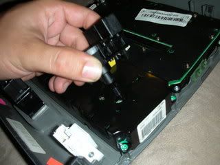

First step is to remove the center panel from your truck, this is easily done by just grabbing the top of the panel, just above the radio and pulling outward. It is only held in by 8 green clips. Once the panel is out, start disconnecting the electrical harnesses, be careful on the ones with the gray levers, they seem to be on the fragile side.

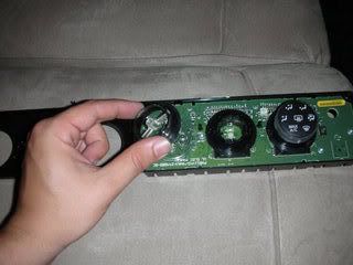

Next, remove all the knobs so they don't get damaged in further steps.

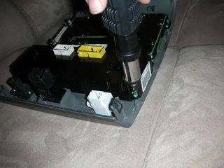

Then, flip the assembly over and remove the fan switch from the HVAC control. After the switch is off, remove the 4 screws holding the HVAC in place, you will need a torque bit for this (i believe it's a T-10)

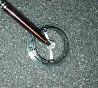

Once you have the HVAC off and in hand, you will see 4 clips holding it together, depress the clips and pop the panel open. Remove the little plastic (barrel) piece, mine was cracked through the center on both sides which explains why the fan switch was no longer gripping. BTW, in case you were wondering, you CANNOT order this piece by itself, spent about 3 days calling around trying to get a replacement so I'll tell you guys how I fixed mine.

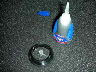

Now that you have the broken piece out. You will need to take the retainer piece off the fan switch (looks like a little black collar) Grab your trusty bottle of super glue (my personal favorite is Loctite Gel) First you want to glue the black collar into the barrel, make sure you don't over glue it, it will cause issues trying to get it back on the switch. Next, reinforce the repair from the outside using the glue, ensuring you fill the crack completely. Before this can be re-installed, you have to trim a little bit of the glue off the bottom of the barrel so it doesn't seize once you get it in.
