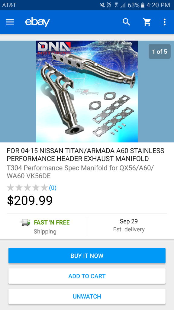

Ok guys here's another cracked manifold question. My T is 2wd non tow gears and has 117k and the mileage is starting to drop off. A little background. I have a maxtrac 4inch spindle lift with a 1.5 inch spacer with bills on the middle perch. Also have 35x12.50r20 Aturro mts. Hate them there impossible to balance. Anyway my milage used to hover around 12-12.5. Now it's at 10-10.5. Im pretty positive the drivers side is done.
I can't any information on these. They look legit and the price is so cheap I just can't pass it up. Anyone use these or have any feedback back for me would be great before I pull the trigger.

They're probably Chinese knockoff JBA headers. Try them out and let us know how they fit. If you do, go with OEM Nissan gaskets.

Hmm just read a bunch of the sellers feedback. Not specifically for the titan ones but so many people said they were junk. I think I'll wait and save for the jba. Can't decide on long tubes or the shorties. I'm in socal so leaning towards the shorties.

Check out Cajun b-pipes. They have a manifold fix kit that includes the headers, the secondary pipes that go after the headers (which you'll need), and uprev so you can tune it. I think their package price is a hair cheaper than if you sources them all by themselves.

So no go with these DNA Headers huh?
