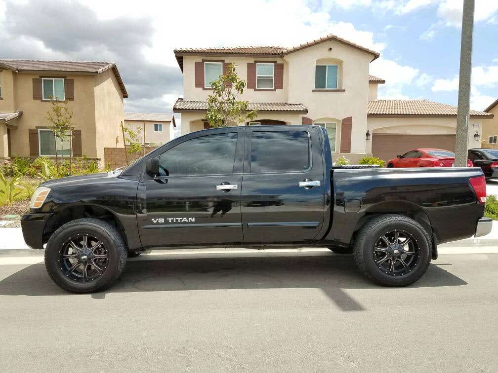

Installed PRG tie rods, sway bar bushings and extend end links and fixed the bolt, bearing and spacers on my lower strut. I was unable to remove my driver's side tie rod. I used a lot PB Blaster and BFH but couldn't get the job done. So, since I had to get an alignment anyways I had Pep Boys give it a try. It wasn't easy but they were able to beat it off with a BFH. I guess they had better leverage since it was on the lift. No more squeaking or popping.
I habe the LCA bushings and spacers but I probably won't get to those until I get to Florida. I also have the bushings for the steering rack, I will give those a try sometime this week if I get time. Right now I have to figure out this tranny temp gauge issue.
So, I finally had time to install it and I stripped the sensor while trying to screw it in to the test port. Looks like the threads on the sensor and plug are not the same. Curious if anyone out there has installed the Autometer temp sensor in the test port without any issue? Maybe I'm just a retard (highly possible).

For the last few months, at low speeds, I'd hear this clicking clacking and ticking sound in the rear, sounded kind of like a rock was stuck in my tire, but I knew it wasn't. I just kept driving it as I was busy fixing all the other things... Anyway...
I just tore into my parking brake issue the last 2 nights. Tuesday night, I tore it apart and the e-brake shoes and 1 of the springs were just laying in there at the bottom inside the rotor.... I took it all apart, cleaned up all the rust with a wire wheel and put it all back together. Just getting both springs back in place took about 1.5 hours. I even bought a tool from autozone.. what a waste! no help whatso ever! Shoulda have just bought the needle nose vice-grips!! anyhow the shoes still moved apparently, the e-brake didn't work and worse, the 1 spring is just scraping against the speed sensor gear making horrible noises... Yesterday I got fed up with it... Removed the pads, removed the little spring. So I just have the 1 large spring holding and those annoying little clips holding everything together... It doesn't work, but hopefully everything stays put. I don't need an e-brake. There wasn't any e-brake on the passenger side at all when I bought it, figured someone else got fed up with it and removed it.
It's completely noise free now, soo much happier!!! If my mechanic complains during inspection then they can order all new stuff and slap it in there b/c I'm sooo over those springs!!! lol

Finished the parking brake last night. Wow! What a difference. So much more resistance on the pedal, I only go in about halfway now. The brakes weren't all that bad. The left side had plenty of rust but nothing that made me think that they were going to disintegrate. Even though, still very happy that I changed them out. I now have the peace of mind and a working parking brake.

Finished with tranny temp gauge. It took me a while since I had to order a metric adapter and a short sweep electric cylinder head temp sender in order for it to fit in the test port. Of course something didn't go right. Went on my first test run and the temp maxed out on the gauge. I figured it was the electrical wiring because I wasn't towing a trailer and it wasn't that hot out, maybe low 90s. The instructions told me that the ground wasn't needed since the sender would be grounded with the treads. Luckily I had routed the wiring anyways so I didn't have to disconnect anything or pull the dash apart again. I went for a 15 min test run and it didn't go past the 150 mark. The outside temp was in the high 70s during the second run so I will check again tomorrow.
Oh yeah, I stole Rage232's idea. I put my gauge on the center dash too.
