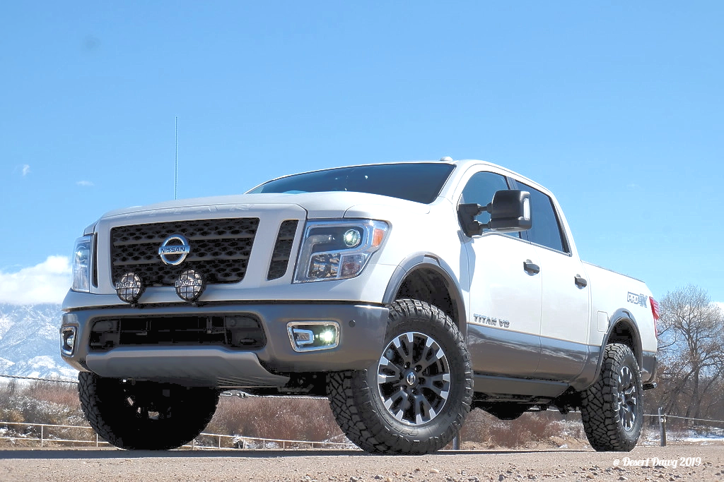

As it currently sits:
My modifications to date include the following:

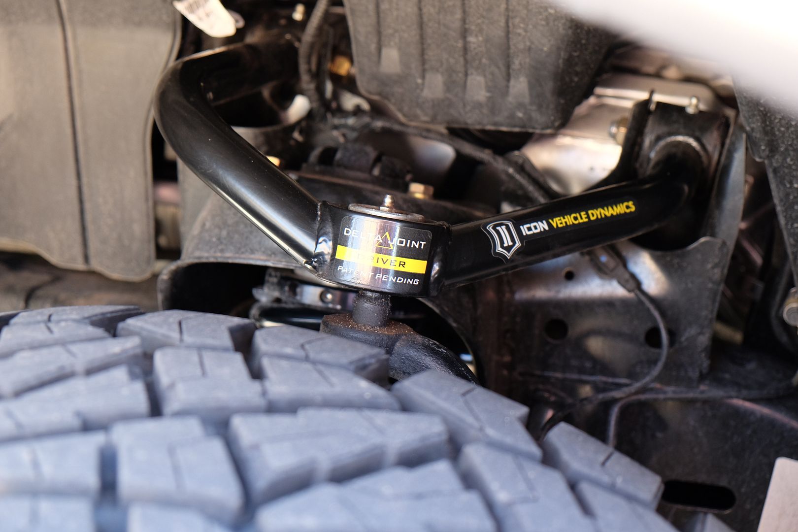

• Nissan-ICON 3-inch Suspension Lift System
- Adjustable ICON 2.5 Series coil-overs
- ICON 2.0 Aluminum Series rear shocks
- Custom ICON rod end bearings
- ICON Delta-joint upper control arms
- Rear lift blocks
• Nitto Ridge Grappler Tires
- LT285/70R18 (34 –inches tall)
• Borla Billet Aluminum 1.5-inch Bolted Wheel Spacers
• Bodywork Trimming
- Lower wheel well sheet metal, fender flare, and liner
• PIAA 6-inch Off-Road Lights
- 520 Series All-Terrain Pattern (ATP)
- Custom fabricated light brackets
• Air-on-Board LED Light Bar Switch
• MagnaFlow Stainless Steel Catback Exhaust System
- Polished Tip
• RetraxPRO XR Locking Aluminum Retractable Bed Cover
- Integrated Trax Rail System
• AMP Research Power Retractable Side Steps
• Maxout Chrome Dry Chemical Fire Extinguisher
• Falcon Zero F170HD+ Dash Cam with GPS
• Escort Max 360 Radar Detector
• VIAIR 400P Portable Air Compressor

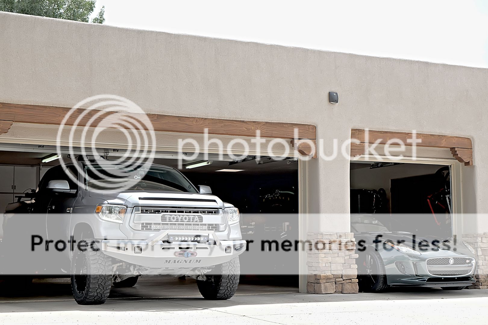

My last build on my Tundra was setup for more serious duty with a King suspension and lots of other goodies that I got to test out:
Anyway, I just enjoy getting outdoors with my 4x4s and like sharing in case I can give ideas. I usually post my off-road adventures on the forums so folks can see that I actually use them and not too much of a poser…lol. I used to have dedicated Jeeps and such but hated the fact that they mostly sat in the garage waiting to be used (my old Broncos where a testament to that). I rather have my sports cars sitting around waiting for weekend drives...lol. So if I am going to use my daily driver for my impromptu weekend adventures (I live very close to NM mountains and also to Colorado), it is very convenient to just load the family and go with a truck that is already well equipped. Unfortunately, the places I like to go are typically not too friendly with a stock factory truck (especially the newer ones with lower front ends and less clearances) without some enhancements. Even with that, my current setup will still need more tweaking if I want to go to my usual places.

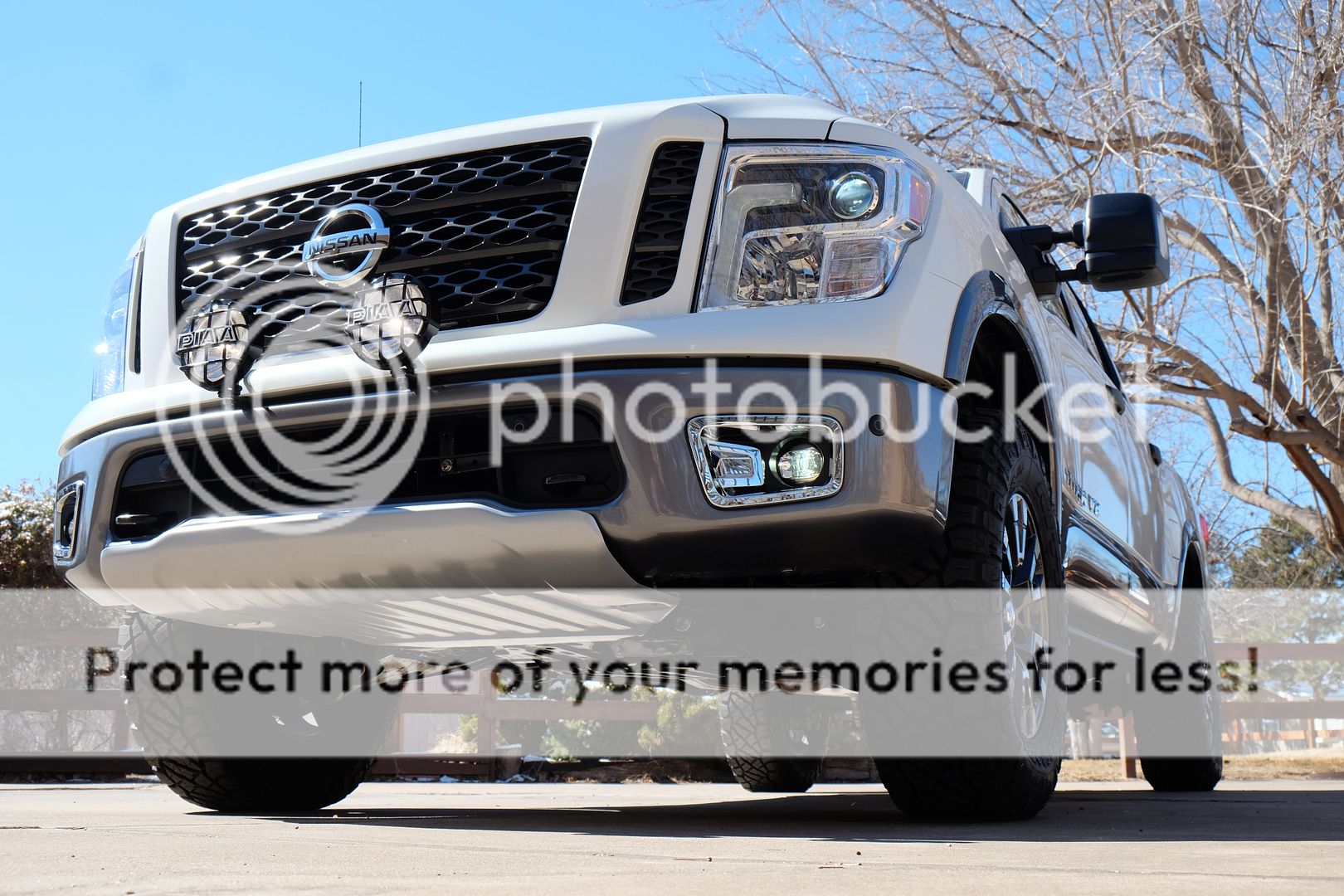

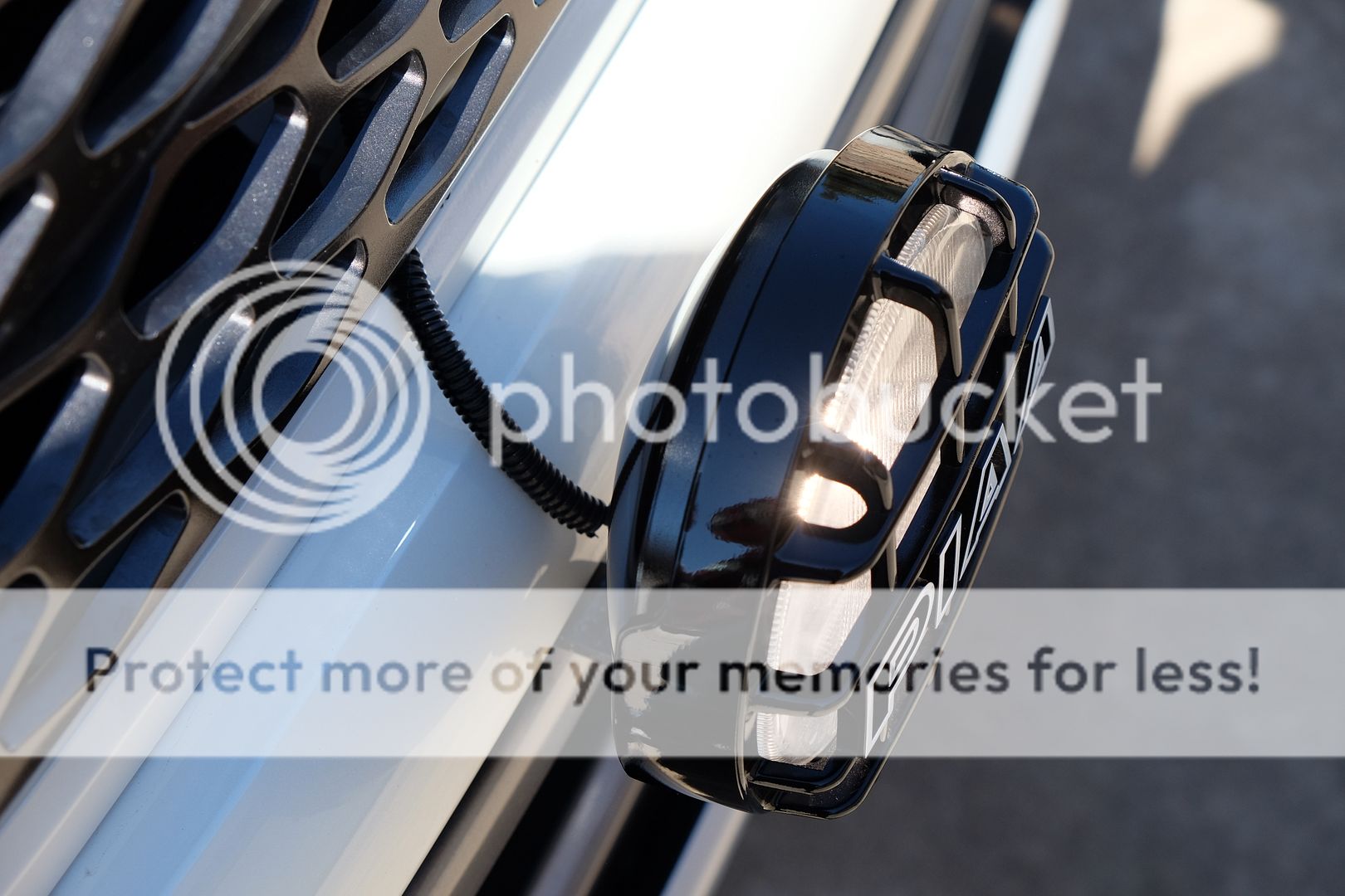

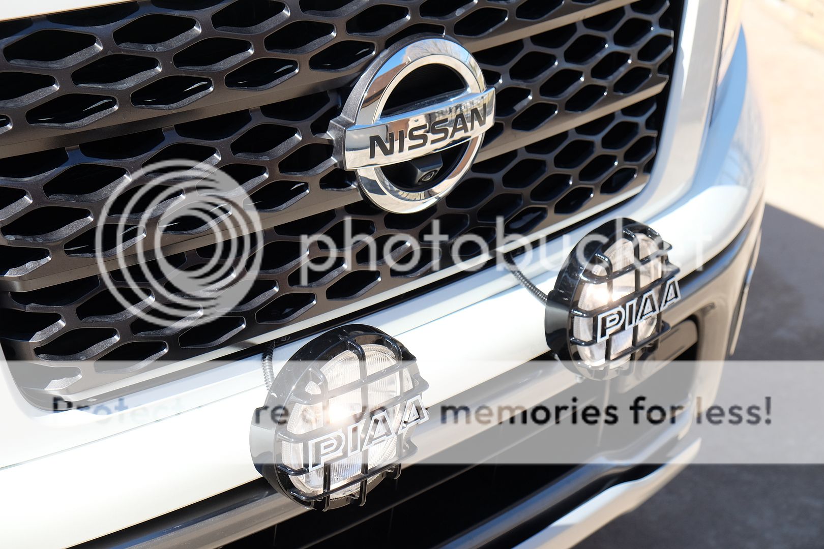

I had an inquiry about installing the PIAA lights since there are no aftermarket light bars offered for the non-XD Titans yet. I simply fabricated the mounts myself with 10-inch long x 1/8-inch SS bars and 6-inch SS angled bars purchased from Home Depot; I drilled out the existing holes to fit larger 3/8-inch SS bolts and hardware. I painted the bars with hammer-steel gray paint and attached the bars to the existing frame bolts that are located behind the front sonar cover plates. The angled bars had to be drilled out more for the 1/2-inch PIAA mounting bolts. The bars extend through the slot between the top of the bumper and front grille; I also glued some rubber bump strips on the bars to keep the metal away from the paint. Eventually, I will remove the bolted mounts and have everything welded, filed, and powder coated for a more permanent fitment.
For wiring, I had to remove the front grille and snake the harness into the engine bay. I used wire loom until the wiring passes through the firewall so everything looks factory clean inside the engine bay. The light switch is an Air-on-Board LED switch that fits in a factory blank located in the dash next to the Cargo Lamp switch; again, everything looks like factory and works great!

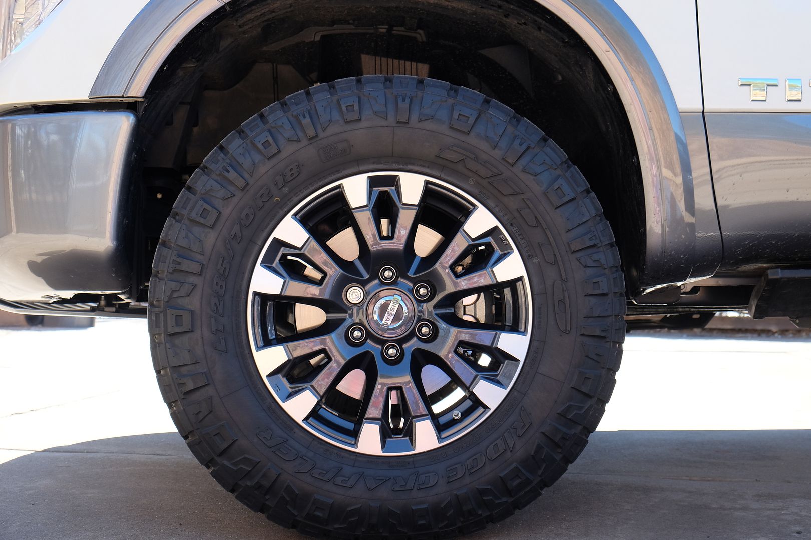

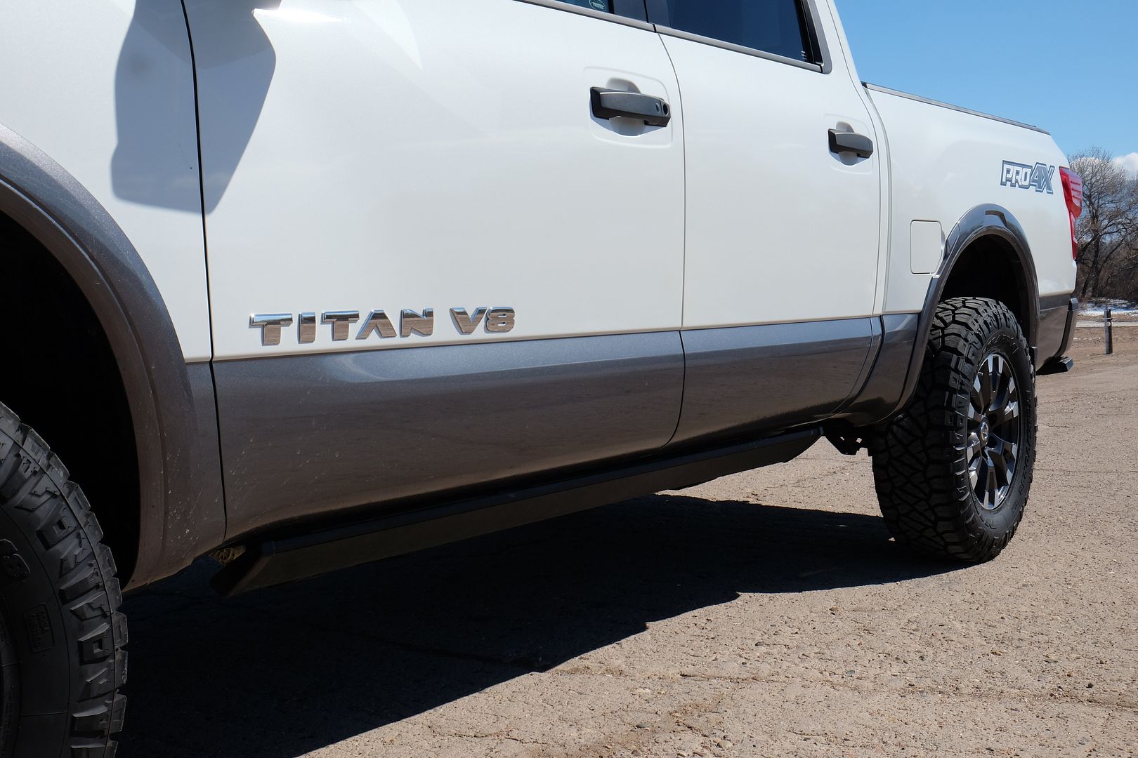

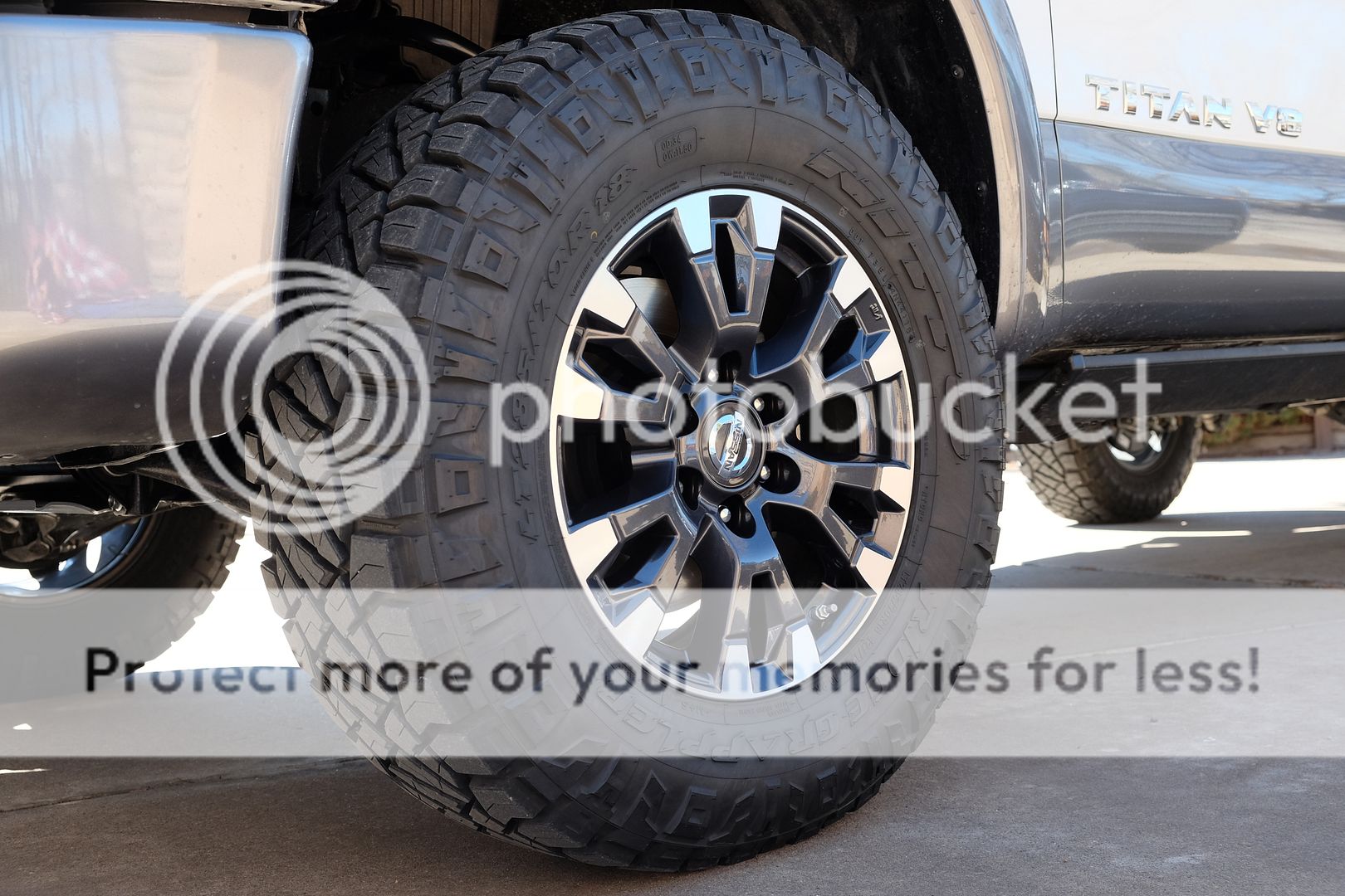

For the lift, wheels, and tires, I was trying to keep more of a factory look but also wanted better performance with a slightly more aggressive stance. Also, since I really like the factory PRO 4X wheels, I was not going to go aftermarket like on many of my other past builds.
Since I do take my daily driver vehicles off-road, I prefer coil-over lift systems (which provide better on-road and off-road performance) so I try to refrain from going with true drop-bracket lift kits (which require cutting/welding, typically result in a higher center of gravity which reduces on-road performance, and provide limited enhanced off-roading performance although they do afford more room to run larger tires); I have certainly used them in the past (i.e., Rancho, FabTech, ProComp, BDS, etc.). At the time of my Titan purchase, the only suspension systems offered for the non-XD Titans were the Rough Country 3-inch system (that uses a front spacer system which restricts off-road performance) and a 6-inch lift which is fine for getting the lift and stance but is too high and designed mostly for street use and light trailing and not very suitable for moderate off-roading on harder mountain trails or desert running (not to mention that RC components and similar systems are not in the same league as Rancho or BDS, etc. so not confidence inspiring when you're traversing a mountain trail at +12,000 ft....lol).
However, I do find the newer drop-bracket hybrid systems intriguing that integrate quality drop-bracket components with higher performance coil-over suspensions like the BDS 4-inch coil-over systems that keep the center of gravity relatively lower but provides the performance of the Fox 2.5 Series remote coil-overs and allowing up to a true 35-inch tire; unfortunately, BDS (like most of the other higher quality suspension manufactures) do not yet offer anything for the newer non-XD Titans. So I opted for the Nissan-ICON package that utilizes the ICON 2.5 Series adjustable 3-inch coil-over system (with ICON UCAs) and rear ICON shocks. You cannot purchase this system directly from ICON as it is only offered through participating Nissan dealerships but the goods news is that the system is fully warrantied by Nissan. ICON is a well respected, quality, high performance product similar to Fox and King. The downside is that the package also includes the additional Nissan components such as the side steps and sport bar that is mounted in the bed (which limits bed covering options). So I ended up selling the unwanted components back to the dealership. Once installed, the vehicle was realigned very closely back to factory spec.
After installing the ICON system, I also needed a slightly larger, more aggressive tire that would serve me well both for daily driving and weekend-warrior duty. Over the years, I have run several brands and tire types including BFG (KO, KO2, KM2), Cooper (S/T Maxx, STT PRO), Nitto (Trail Grappler, Rigde Grappler), Goodyear (Duratrac), Cepeks (Fun Country), General (Grabber), Yokohoma (Geolander) among others. My all-time favorite tire to date is the newer hybrid (relatively speaking) Nitto Ridge Grappler as it is very quiet even at highway speeds with no intrusive humming, provides great dry handling performance and turn-in feel, and superior wet condition performance in rain, snow, and ice. On top of all of that, the Ridge Grapplers are excellent moderate off-roading tires for loose sand, slippery rock/hard pack mud, and boulder trails. The only condition I have not tested them on is in deep mud where they probably won't do quite as well as a true mud tire. But I am not setup for deep mud trailing anyway since I purposely maintain a lower center of gravity with under 35-inch tires specifically for trails in the Southwest and Rocky Mountains (and the fact that deep mud in the Southwest is a rare occurrence anyway...lol).
The Nitto Trail Grappler tire I selected is a LT285/70R18 size which is basically a 34-inch tall tire. However, to get the stance I wanted, I also installed 1.5-inch BORA bolted wheel spacers all around. This required removal of the front mud flaps, substantial trimming of the fender flares that extend in the wheel wheel, performing the Pinch Weld Mod, and cutting the wheel liner so it would tuck back in behind the folded sheet metal. I sprayed painted the mod so everything blended in for a clean look. Being able to tuck the liner further back behind the sheet metal lip created during the PWM meant I didn't have to heat up and warp the plastic liner; very clean result and no rubbing at all on any components or body parts. I do have very mild rub on the liner at hard lock turns when backing up but no rubbing at all during hard forward turning. For off-roading, the tires have plenty of clearance for full wheel articulation with the new suspension and allowing the treads to unpack.

lights are clean! Not my style (obviously since i had 11 cubes on the front of mine lmao) but solid work DIY'ing it.

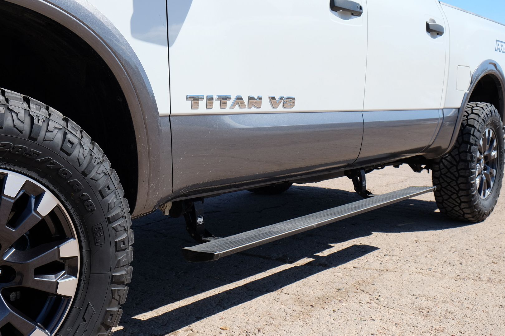

For those considering the power side-steps, I highly recommend them as I have installed them on at least five of my trucks with never an issue. The steps tuck nicely under the body which leaves more clearance for off-roading unlike most other side steps (especially factory ones). The steps have a great drop depth so very easy for smaller or older passengers to climb in. Also, you can keep the sidesteps extended by keeping your foot on them while closing the door which is great when you're cleaning the vehicle or needing access to the roof with the doors closed. The steps are relatively quiet and provide almost instantaneous response when opening and closing the front and/or rear doors.
Steps extended:
Steps retracted:
The cons; the steps are expensive and by no means serve as rock sliders (they will just crush) so you'll get raised eyebrows out on the trail...lol. Also, it has been reported that in colder climates the actuators can ice over but I have not seen that myself.
Installation is pretty straightforward for the average-joe mechanic. The only issue I had was drilling into the high-strength steel to insert the mounting rivets (only done for the first hole on each side as the rear uses the factory pre-drilled holes). I did not bother installing the LED step lights as I have puddle lights already and just didn't feel like having any more wiring under the truck than necessary.

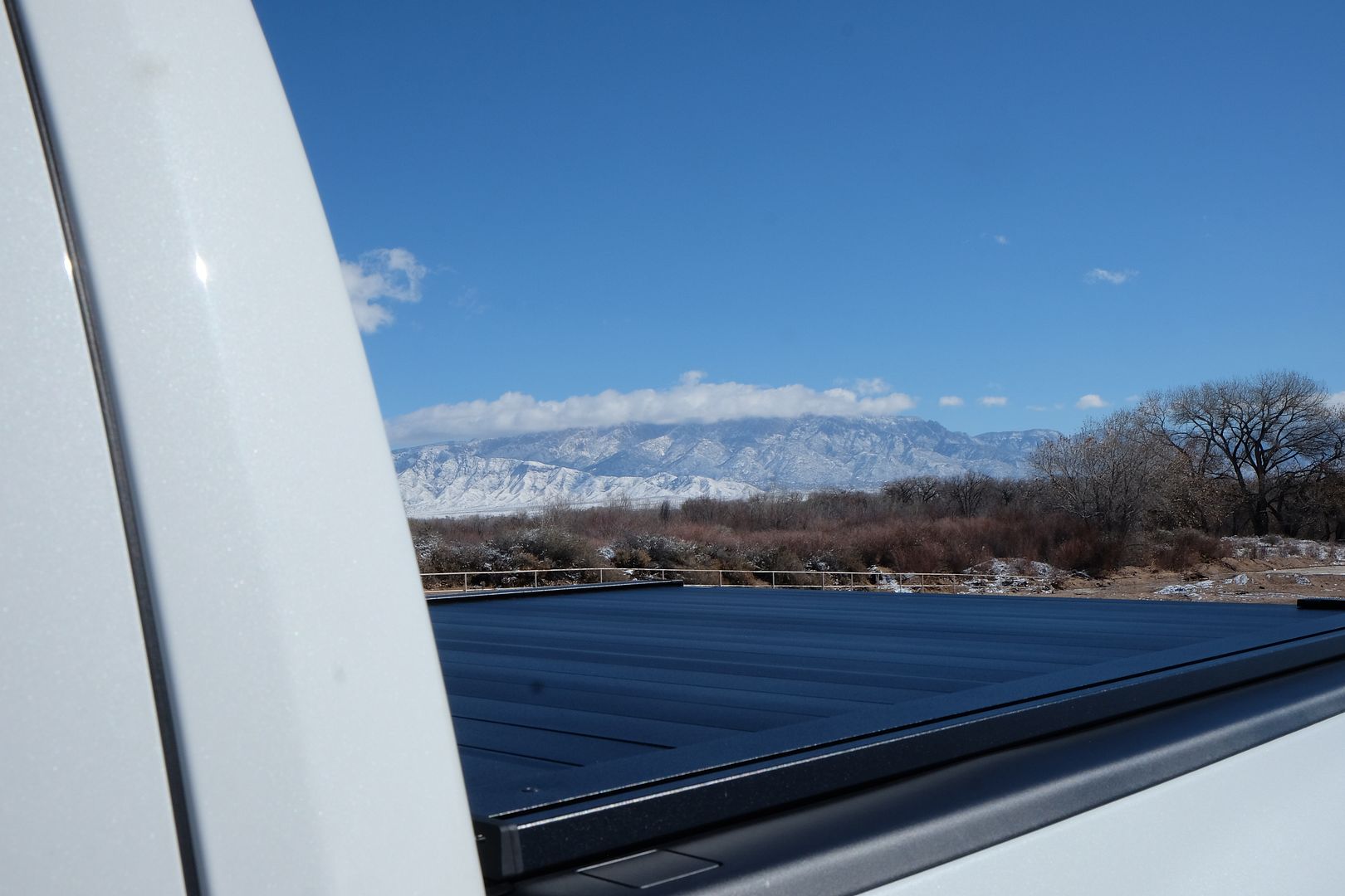

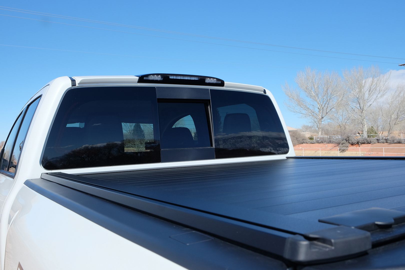

Even though I purchased the Nissan-ICON suspension package that came with the sport bar and side steps, I knew I was going to switch out for the AMP Research power retractable side steps and a hard tonneau cover for the bed. Keeping the sport bar would also interfere with any current hard bed covers that are available so I sold both components back to the dealer. For the tonneau cover, I prefer the retractable versions; typically, these covers are available in polycarbonate or aluminum. While the polycarbonate versions are cheaper, I really didn't like the fact that they are not near as durable or protective as the aluminum versions.
I have used Pace Edwards and Truck Covers USA aluminum covers before, but this time around I gave Retrax a try. I opted for the RetraxPRO XR which integrates their Trax Rail System with the tonneau cover and allows for the installation of Rhino Rack, Thule, or Yakima rack systems; this was important since I like carrying my skis and bikes on top of the bed for long travel trips (keeps the bed free for luggage and/or other gear while also preventing the bikes from getting beat up if in the bed). I will be installing a Yakima system since I already have the bike mounts from my previous Tundra setup:
Installation was fairly straightforward and supposedly requires (2) people but I was fine lifting it into place by myself. The cover allows you to keep the factory Utili-Track system without having to relocate it with drop brackets and is key lockable in any position. The system is very sturdy, quiet and looks great to boot with a nice clean, low profile design. The downside is you do lose about 12-inches of usable in-bed storage length due to the storage canister so not ideal if you actually haul a lot or need the space for dirt bikes, etc. But you do retain some load space for wood, gear, or luggage under the canister (the under-canister space works well for me since that is where I secure my utility case for extra gear when off-roading or traveling). All in all, very functional and will post pics once I get the Yakima system installed.

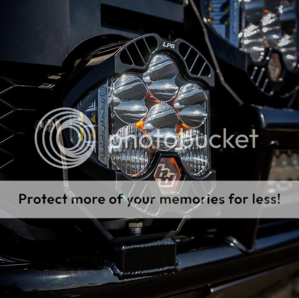

We have got to get you on the BajaDesigns stuff man. LP6's would be baller on the front end. I'm running 4 of the peasant level squadron sports and love them.
#51 ·
Totally! I had the LP6s on my initial list of mods but didn't want to invest in them without a more beefy (and attractive looking) mounting system for the front end. I was hoping to find a custom "light duty" front bumper as I am not a fan of the massive Fab Four offering (too heavy looking on the new Gen 1/2-ton front ends) or maybe another N-Fab style light bar (I had initially contacted them since they are using one of my other builds on their website and thought they might be excited about trying one out for my new Gen Titan...but the answer was "no"!).
The way I custom fab my own is just fine for the lighter and thinner PIAAs but not for LP-series. Even then, my fab is not the long term solution either. If I can figure out a light bar solution, I would absolutely love having the LP6s (I think the LP9s are too big for my setup).
I haven't had the time yet, but I am thinking of fabricating my own 1.5-inch dia. light bar. The front end behind the grille is useless since there are no structural supports that are easily accessible and the whole space is taken up with the active shutter system (and so no room in front of the system even if you did have some structural components to tap into). So you have to tie into the front tow hook locations way down low (and possibly lose those) and design some creative bends to get the mounting bar in front the grille; need to fab some custom brackets to bolt to the side of the front frame extensions (using the existing tow hook bolts and pre-drilled mounting holes), bring some welded side arms out of the lower bumper area while allowing enough space to not interfere with the front sensors, extend the arms up to just over the bumper line, and extended out just far enough in front of the grille to clear the thickness of the LP6s while looking attractive at same time...lol. I think it's doable but will take some time to create a mock up first. No wonder no one has offered a quality looking light bar for the new Gens yet.

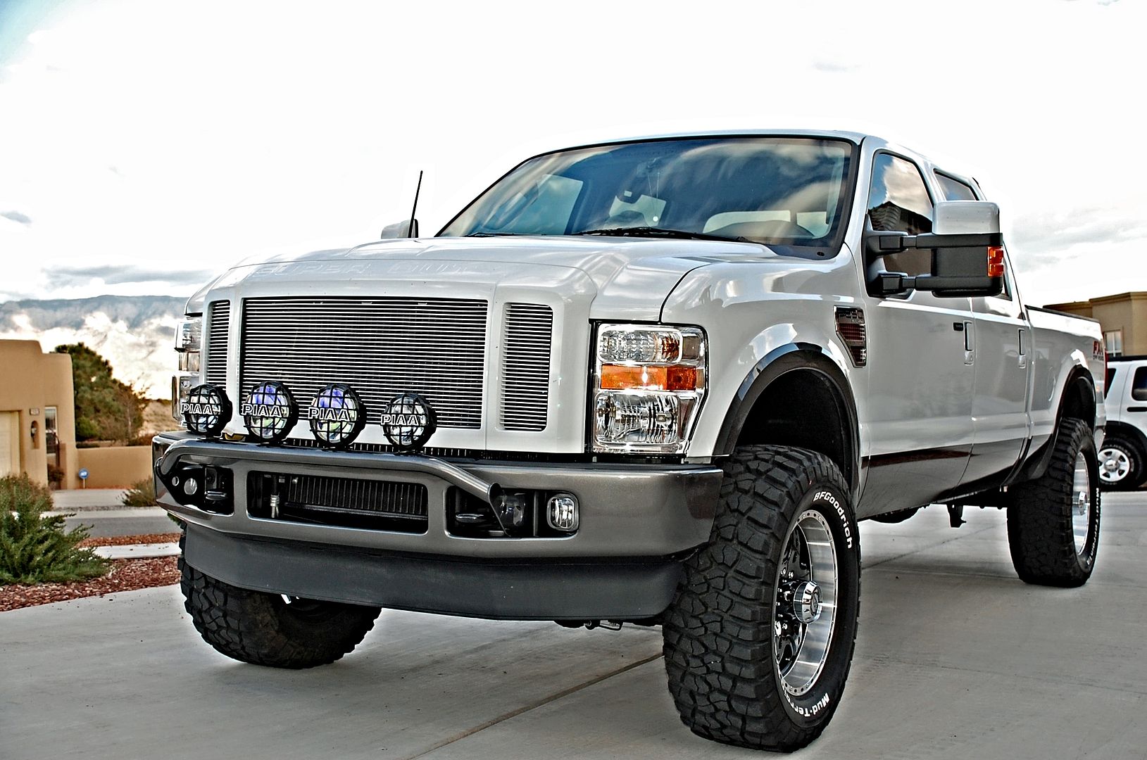

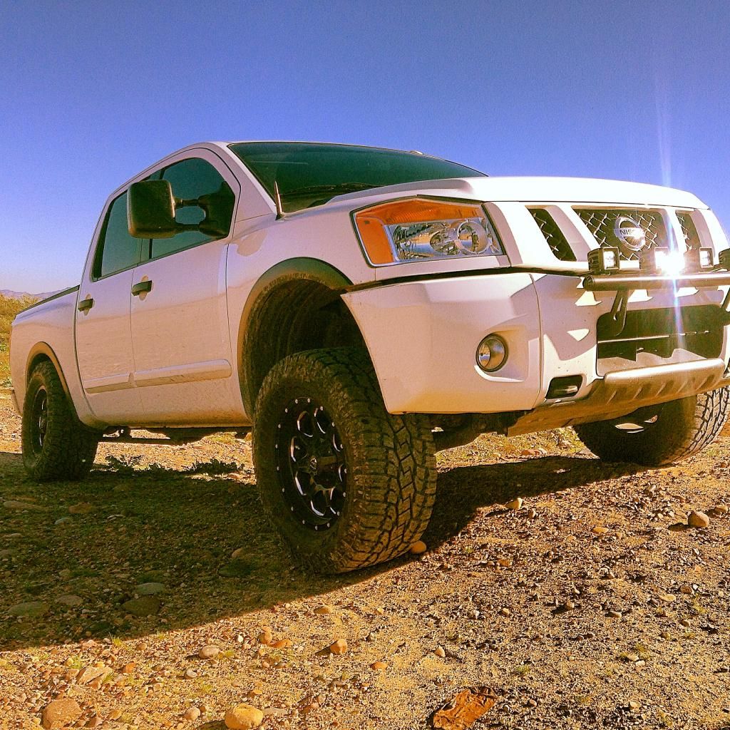

The "Defiant" brand light bar I ran went in through the lower grille opening and bolted to the side of the frame rails to the existing holes. it made it ridiculously solid.Like you said, they had some nice metal work/bends to make it work. I bought it used, and now a current member is still running it. so that's proof to how well it was built.
http://i1083.photobucket.com/albums/j393/honda250xtitan/IMG_5692_zpsgwre4w6f.jpg
https://photobucket.com/gallery/use...a250xtitan/media/cGF0aDpNb2JpbGUgVXBsb2Fkcy9pbWFnZV96cHNqaWx4cjB2NS5qcGVn/?ref=
I bet any decent shop could built it for you.
