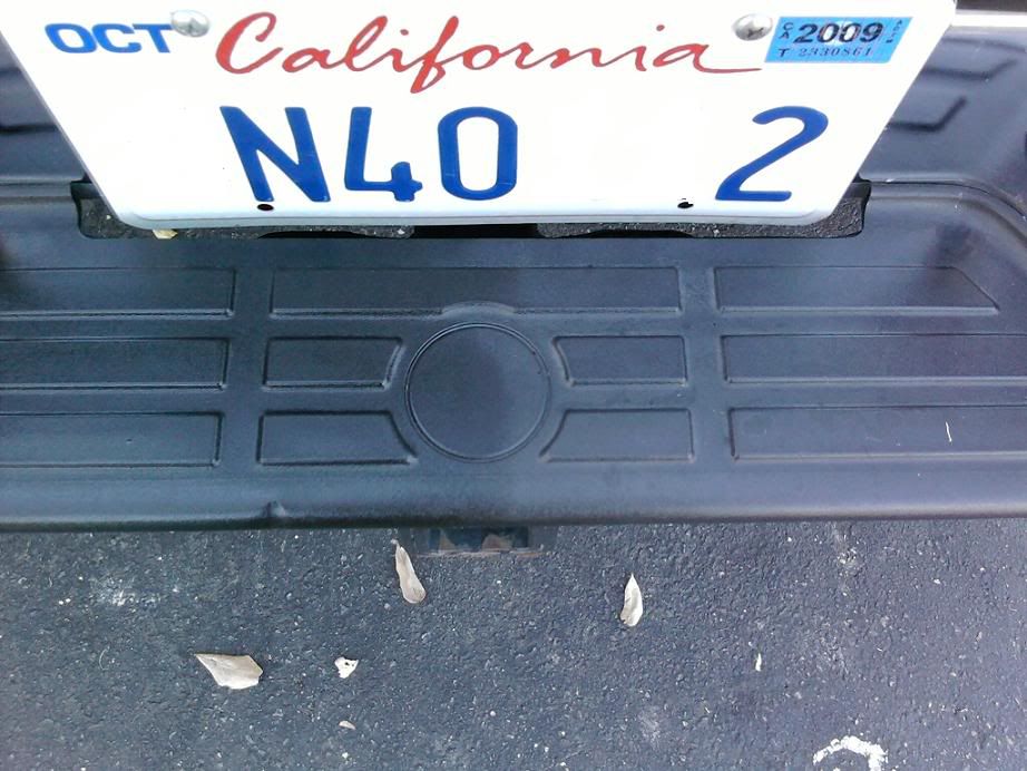

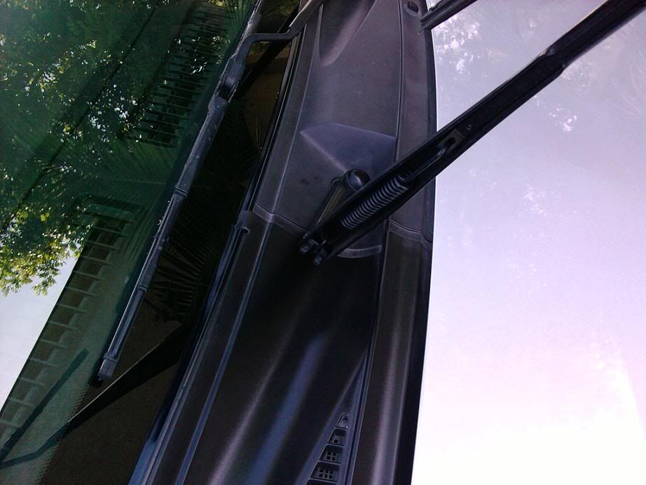

Well guys and gals some of us ask how can i restore our plastic trim on the exterior of our Nissan Titan? Since Nissan always uses cheap plastic...lol. Well for starters on the Titan the plastic on the Wipers under the windshield always fades. It turns to a light gray as for our OEM mud flaps too. Followed by the trim on the trunk and rear bumper. Well if you dont wanna spend too much money you can purchase a plastic restorer from Mother's called Back to Black, ruffly around $7. To apply you will need a round wax pad and your set. NOTE on the trim located by the windshield you will have some residue but will dry so no need to panic. Here are some pics of half apply and other half faded.
Windshield trim
Rear bumper trim
