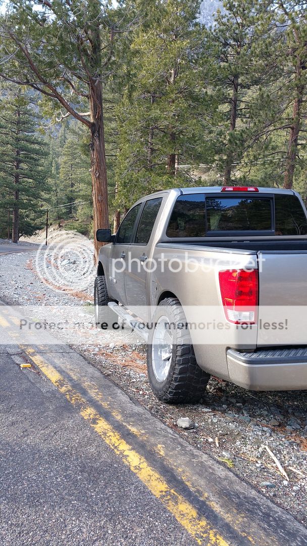

It was basically like this but just flexing a tad bit more. Idk how but even the rear tire that had perfect traction was tucked further than what it was in this picture... And in this picture it was loose rocks/gravel and it spun the wheel on the other side everytime I gave it gas. Launching rocks everywhere and it doesnt even look that bad .. Good thing I was able to back out.
