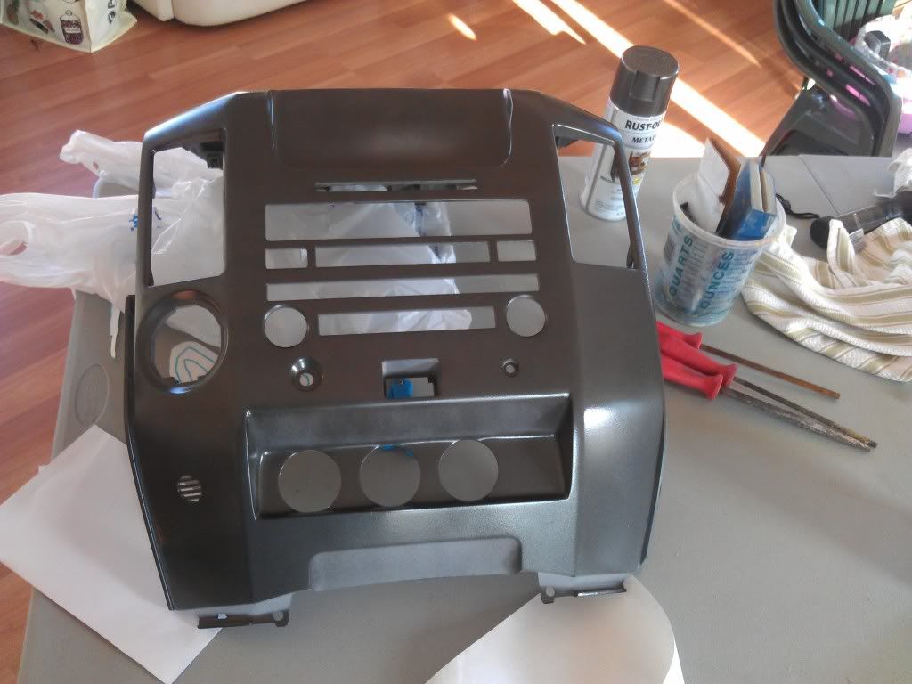

after a few coats, kinda screwed it up. Gonna have to sand down and redo but wanted to get a good picture of what it would look like. nevermind the pits where the tablet goes, gonna be covered up anyway

picture from this morning. not liking the paint. too glossy and I think it may be a little too dark. Off to find another shade of gray.

painting round 2:
Think that I found a paint color that almost matches the stock Nissan Titan bezel/trim
hard to tell from the pics, as the paint is drying but as close as it gets...gotta find a trim peace to match tho
about 4 coats in.... wish I had a garage to work in, its windy and messing up my paint job
now literally sitting, waiting for the paint to dry
Discussion starter · #29 ·
still gotta dry, but its almost there... hopefully a light sanding, polishing???? if not, gotta go buy another can of paint
Still gotta test fit!!! hope everything still lines up
Discussion starter · #30 · (Edited)
I'd say pretty damn close to stock color, used 4x4 switch cover for reference
here is the color used

Discussion starter · #33 ·
test fit ok.....
I think I gotta redo the paint... not happy at all, but it will have to do for now

Discussion starter · #35 ·
from the pics the paint looks like a perfect match. Nice work.
it did.... then took some polishing compound to take out the sanding marks and boom 3 shades darker...lol
