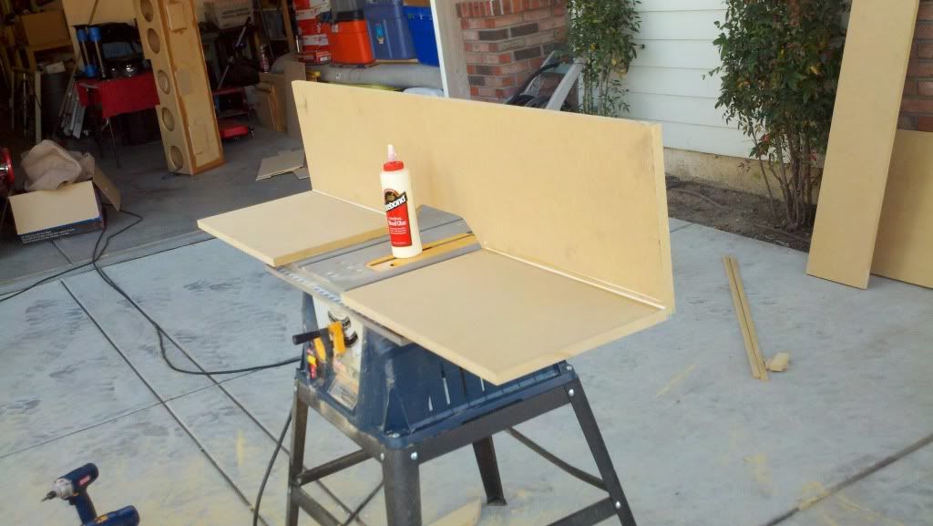

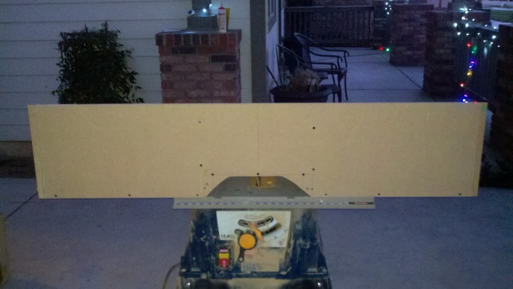

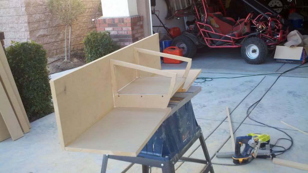

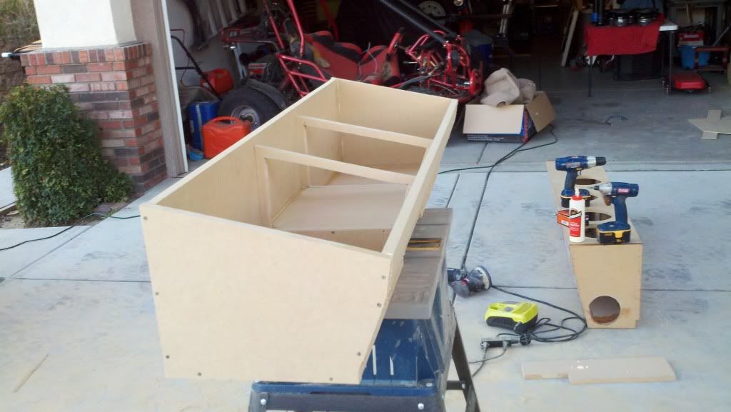

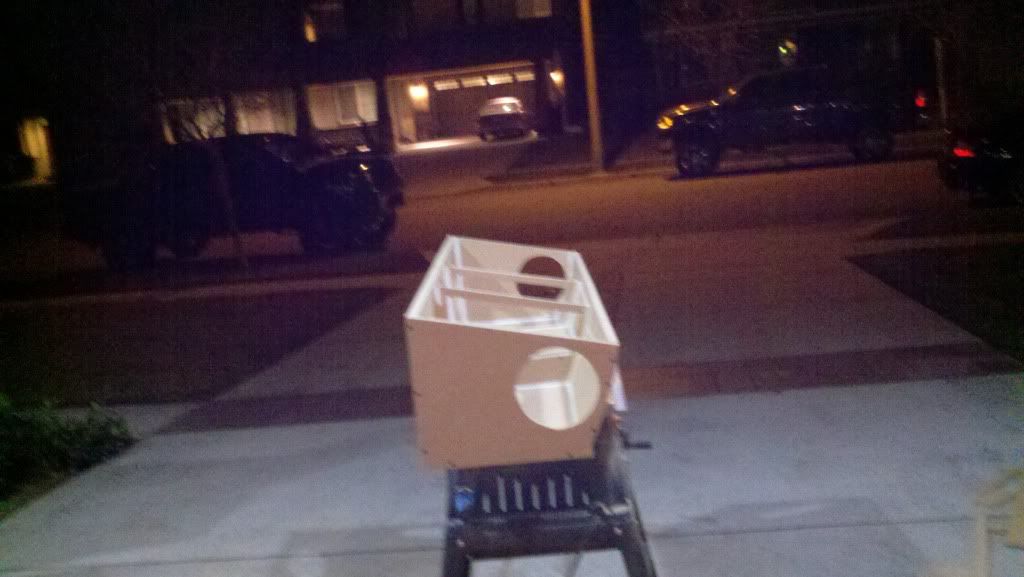

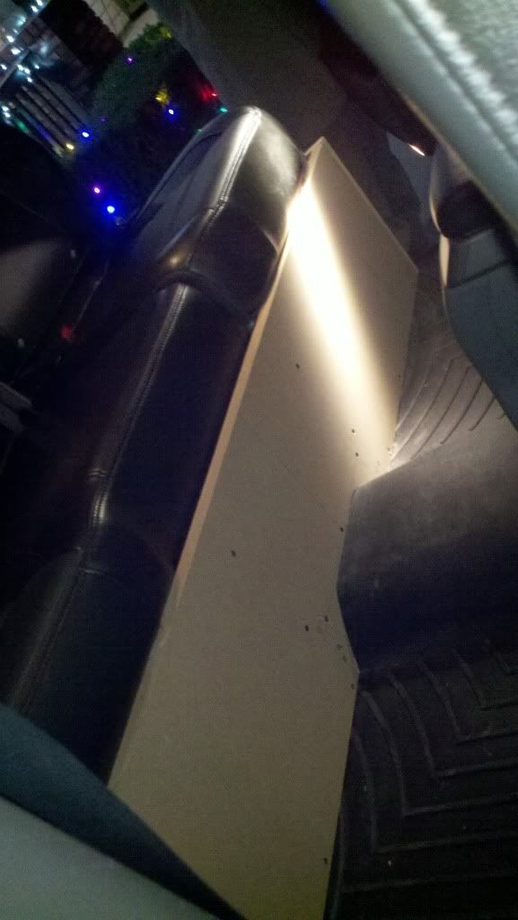

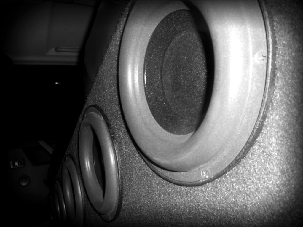

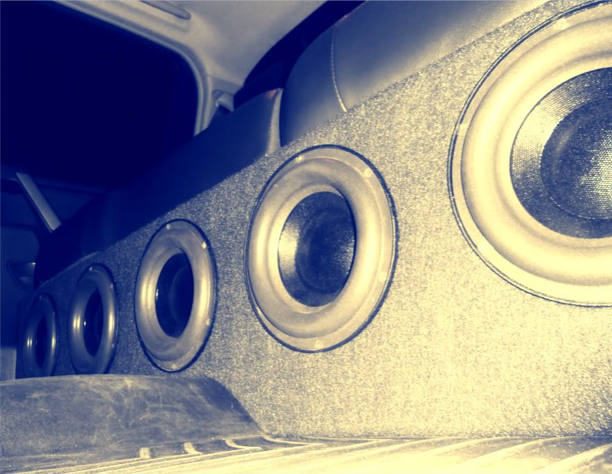

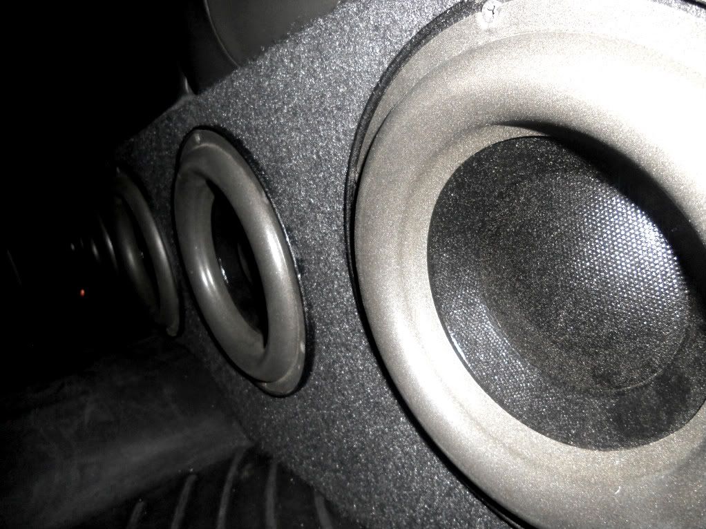

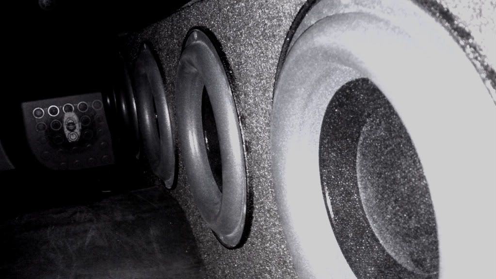

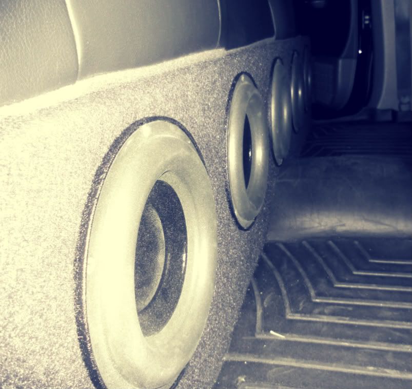

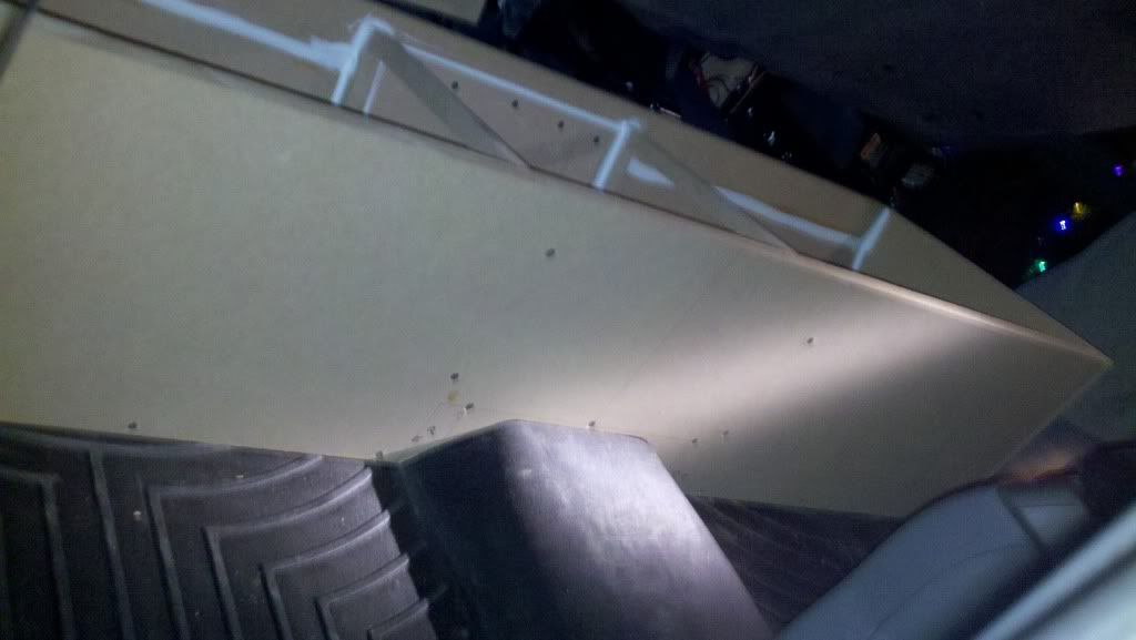

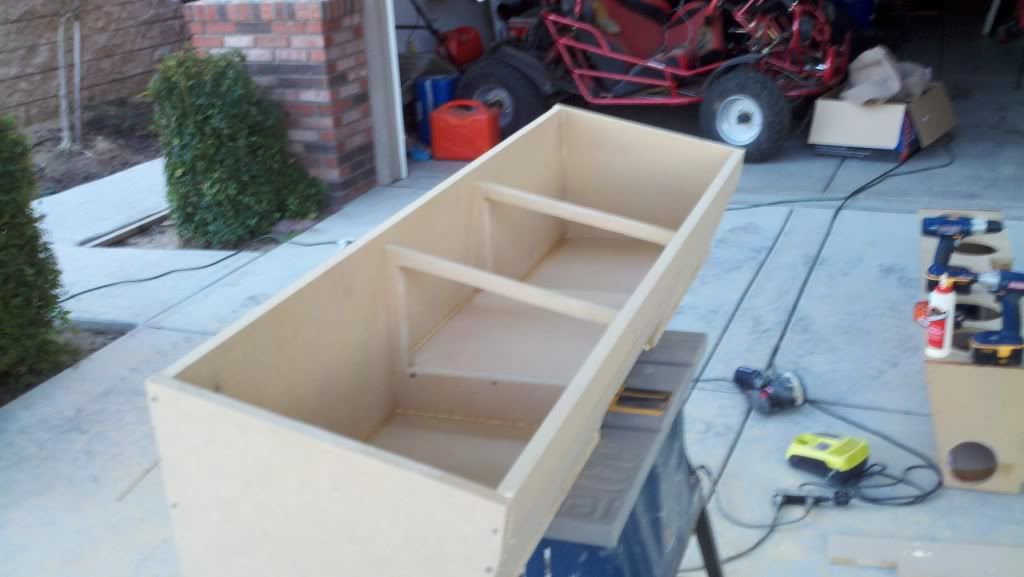

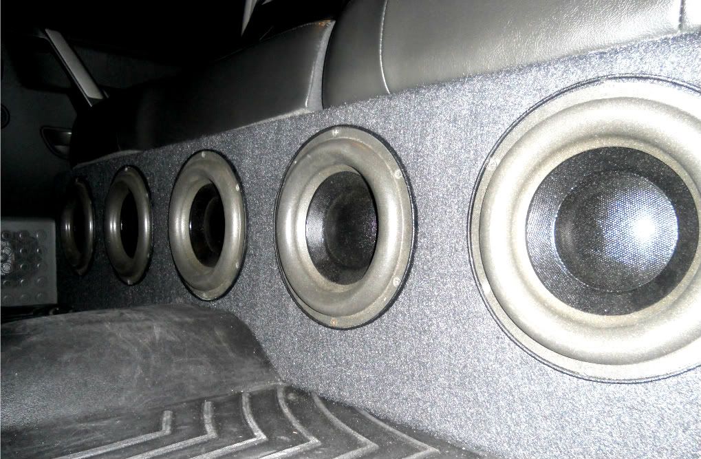

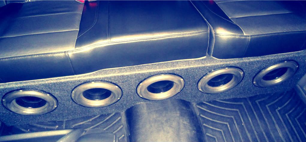

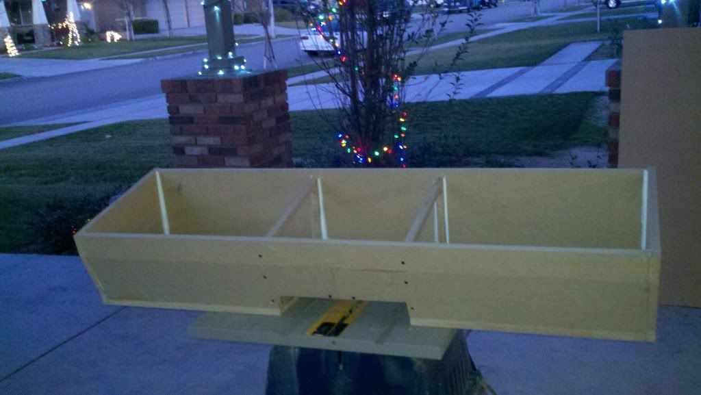

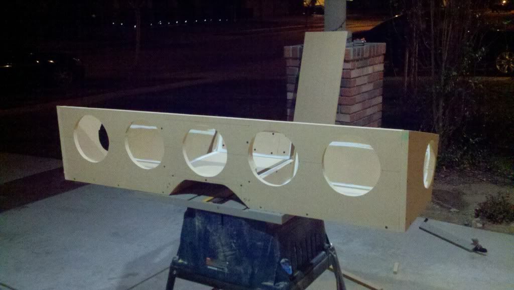

Here are some pictures of a box that Cali_Screw made for my T with a 2" Seat lift. I haven't taken final pictures because we finished it about 12 AM, and had to sleep for the HB meet. Hopefully some of the people I demo'd for at the HB meet will chime in on how it sounds. :hi:
Will try and get finished pictures soon. :)

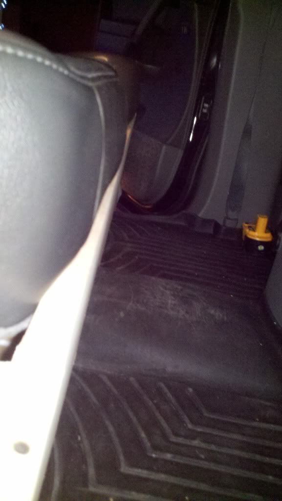

Looks like a beast of a box. I've got a tech12volts dual 10 box but I need to do the 2" seat lift also because when the subs are hitting hard they hit the cloth on the bottom of my seat causing a popping sound. I've read the threads for the 2" seat lift but I can't find a place that sells the pieces needed. Any ideas?
Hit up SD_Titan for the kit! It's never good that the subs hit the bottom of the seat. Is it because the box is too tall? Do the surrounds stick out?

Some curious questions sir....
Port Diameter?
Port Length?
Type of Subs?
# of vc and Ohms?
Thanks for any responses. Sweet setup sir
#13 ·
2 4" Aero ports, that are 12" long. Tuning is still high, so i will probably extend them to try and it to around 33 hz. The subs are Sound Splinter Orphans (TC Sounds made) with SVC 6 ohm coils (read 5 ohm on dmm)...
